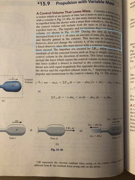

I think ##v_{e/r}## could be anything. The reason why I say that ##v_{e/O}## is constant is because once it leaves the rocket it's not accelerating in the inertial frame. So the "packet of ejecta" that changed the rockets momentum is moving at a constant velocity w.r.t ground. but, not the same velocity as the other packets. Is that making sense? The mass of ejecta is accumulating, but the momentum of currently expelled mass is constant in time.
That is my interpretation of the following statement in Hibbeler:
But when you write ##p_{ejecta}##, that is the momentum of the ejecta as a whole, so how are you defining the velocity of the ejecta as a whole? The only obvious way is as the velocity of its mass centre, and that is not constant.
If you skip consideration of the ejecta's velocity and just address its change in momentum, clearly that is its added mass multiplied by the rest frame velocity of that after ejection, as desired.

I don’t know. Probably got there by coincidence then. I’m guessing you aren’t seeing a path forward in the that style. Anyhow, the impulse/momentum is easy enough to derive. I was just seeing if it was salvageable.
I wonder if the book derivation is incorrect too for the reason you mention? They say in italics the control volume includes both the mass of the device and the expelled mass. It should fall prey to the same argument you are making?
No, the book argument is fine. It does not create a variable to represent the velocity of what has already been ejected, just notes that its momentum doesn’t change. It should be possible to make what you wrote work with a careful definition of that velocity, but why bother?
