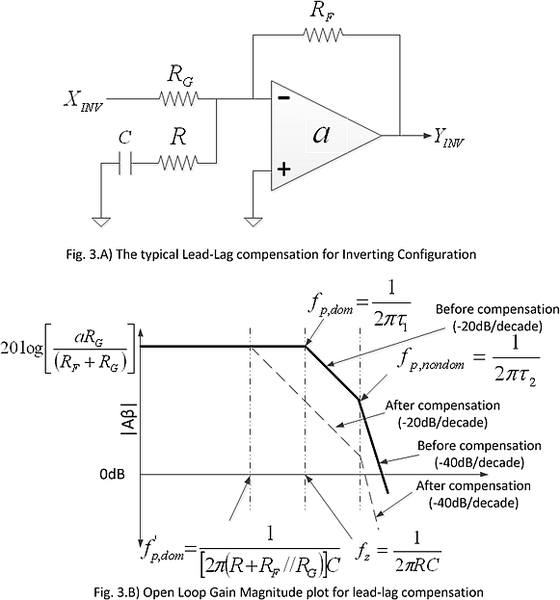

meBigGuy said:
Not quite going the right way.
It seems that we are getting little deviated from the topic...
The main source of my query was two conflicting definition of compensation written in the textbook..please refer the attachment...
First definition.
"The compensation of the amplifier is the tailoring of the open loop gain....."
Second definition.
“The way to prevent this (oscillation) is to ensure that the loop gain( open loop gain minus the feedback factor) falls below unity before phase shift reaches 180 degrees"
How come at the same time compensation is about open as well as closed loop gain..??
This is the source of my confusion...
First definition.
Second definition.
* At first, what is the meaning of your last sentence (..."closed loop gain"...) ?
I cannot find any mentioning of the "closed loop gain" in both definitions.
* Secondly, who told you that the loop gain would be "open loop gain minus the feedback factor" ?
The loop gain L(s) is nothing else than the product "open-loop gain x feedback factor ß": (L(s)=Aol(s)*ß)
* Therefore, both "definitions" are telling you the same: Tailoring the open-loop gain Aol(s) will at the same time tailor the loop gain L(s).
EDIT: Only now I have seen the enclosure (excerpt from a book).
There is a typing error.
As I wrote, the loop gain is L(s)=Aol(s)*ß=Aol/(1/ß) >> in dB: Aol(s)db-(1/ß)db.
Therefore (in words): The loop gain L(s) is "open-loop gain (in dB) minus inverse feedback factor (in dB)".
I think, this can clarify your confusion.

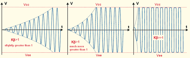

After many days of research on the topic I found that I was confusing my self with loop gain and closed loop gain..."so it was the loop gain which should be take into consideration"...
Thanks guys especially Jony130 for a very useful article (above) which you have provided me...But there is some text in the article to which I partially agree... The text is as follows:-
"If is less than unity, the signals will be gradually attenuated into insignificance despite the fact that they are reinforcing each other at the input"
If the open loop gain (A) depends upon the difference of the signal at the input, loop gain depends upon A since loop gain = , thus its clear that loop gain also depends upon the difference of the signal at the input..so how can we say that signals will be attenuated despite they reinforce each other at input..??
In case the loop gain is already less than unity at the critical frequency (where the additional phase shift reaches a value of -180deg) the closed-loop will be stable.
That means: The input signal and the feedback signal "reinforce" each other - however, this reinforcement is not strong enough to cause self-excitement (oscillation).
Remember the closed-loop gain Acl=A/(1+Aβ) >>>> for 180deg phase shift: Acl=A/(1-||)
If Aβ=1 we have self-excitement (denominator approaches zero). Hence, the loop gain Aβ must be less than unity.
Likes brainbaby

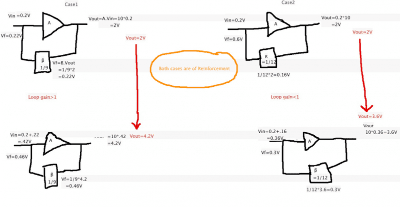

what do you mean by that the reinforcement is not strong...do you mean that the difference at the input is decreasing with every cycle...or something like that...
but reinforcement itself means that the input difference is becoming larger...so weak reinforcement is not making sense to me right now...

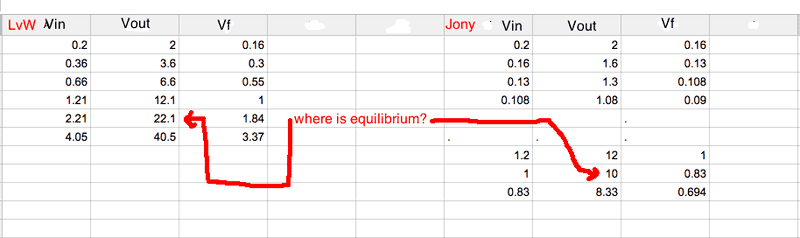

When we speak about stabiliy it is the LOOP GAIN which matters only. That is the total gain around the loop.
Let`s assume we have a gain block with A=10 and a feedback network with an attenuation (feedback factor) of k=1/12.
In this case, no self-excitement is possible because there is no amplification factor larger than unity within the loop (loop gain=10/12<1).
However, for k=1/9 we have a loop gain of 10/9>1 which means: Any increase of the amplifiers output voltage will be attenuated on his way back to the input only by a factor of 1/9 and the amplified again by a gain factor of 10. Therefore, the output signal grows larger and larger (self-excitement).
In contrary, for k=1/12 the gain of 10 cannot compensdate the loss in the feeedback path and, therefore, the signal cannot further rise. In contrary - it will die out.

Your last answer was quite impressive...hence I tried to illustrate it numerically...
My inference from my calculation..
For both cases when loop gain>1 and loop gain<1...Vout seems to be increasing...
In case first->
Vout raises from 2V to 4.2 V and in second case..
Vout raises from 2V to 3.6 V...hence in both the cases Vout is increasing that is against your inference which is for loop gain>1, Vout increases and for loop gain<1, Vout should decrease...
So please tell now where I am wrong...!

I only will comment case 2 (because the same method can be applied for case 1):
You have calculated the "first round trip" of the signals. As you can see, the output signal has increased from 2V to 3.6V.
This can be continued to further trips.
Finally you will arrive at a stable point, where no further increase will take place because we have an equilibrium between input and output.
This equilibrium is reached for:
Vin=0.2V
Vout=12V
Vfeedback=12/12=1v
V(amplifier,in)=0.2+1=1.2V
Vout=1.2*10=12V.
Result: 12/0.2=60
(the closed-loop gain is Acl=60 > A=10).
Formula: Acl=A/(1-A*k)=10/(1-0.8333)=60
Likes brainbaby
But same thing would happen to case 1 also ..but at a more faster rate...so what difference would it make..??
Yes - at a faster rate, but you will not find such an equilibrium as in case 2 (input after addition x gain=output).
Try it.
Likes brainbaby
To see how signal decrease for Aβ < 1 apply a input signal only for one loop "revolution".
For example for Case 2 we have:
We have Vin = 0.2 and Vf = 0.16. But now Vin = 0 so we have Vf = 0 + 0.16 = 0.16 and Vf'1 = 0.13-->Vf'2--->0.11-->Vf'3-->0.09 and so on.
Because now you need more than 60 iterations to get to the stable point at Vin =1.2 and Vout = 20.
And for Case 1 the stable point do not exist.

  • #31
Certainly I got the idea but my results aren't up-to the expected value..
Equilibrium means that the output stops increasing and the output is constant with constant input...ok
@LvW
According to you the equilibrium point is when Vin = 1.21 V but after that you can see in the table that Vout is constantly increasing ...however according to theory it should become constant making the input constant...So where is the equilibrium point ??
@JONY
From the table you can see that as Vin is decreasing.., so after 60 iterations the value of Vin will be very meagre ...but your stable point is at 1.2 V ..i.e at a higher Vin...
So what is this anomaly and where is the stable point??
and one more thing... at Vin=1.2V your Vout is 20V and mine is 12V how exactly??
  • #32
Brainbaby - I am afraid, it is not easy to answer.
Let me try: You have startet this "step-by-step" approach in your post#26 - and I was following this approach (this way to explain what happens) in my reply.
However, let me say, that it is somewhat questionable if we are allowed to apply this "circling within a loop" procedure.
I know that there are general analyses for feedback systems which show that such a "deterministic" view is not allowed because - in reality - there is no signal which is circling n-times through such a loop.
Nevertheless, we have startet this (simplified) view - and the only answer I can now give is:
In your table, you have listed some discrete events (voltages) which are assumed to be existent at some discrete times.
But this is not the case.
Instead, we must assume a time-continuous process.
And anywhen during this process of increasing output voltage we arrive at a point, where we have an "equilibrium" (that means: Output voltage=Input voltage x gain).
In my post#27 I have given the corresponding final value: Vout=12V .
When this condition is reached the gain expression is "fulfilled" and there is no reason for a further increase of the output voltage.
That`s all I can say.
Again: It is a simplified view, which cannot explain all the effects to be observed.
But it can, perhaps, give a rough picture what is happening and why.
Likes brainbaby

You must have misunderstand my post or my last post was not clear for you. For the circuit with Aol = 10, β = 1/12 and Vin = 0.2V the steady state is reach as show by LvW at Vout = 12V and Vin + Vf = 1.2V (Vin is still equal to 0.2V). So the circuit with Aol*β<1 is stable.
To confirm this we can try different method. Let as apply Vin only for ONE iteration (a brief trigger signal) to see what will happens.
Vin'1 = 0.2V Vout'1 = 2V
Vin'2 = 0.16V Vout'2 = 1.6V
Vin'3 = 0.13V Vout'3 = 1.3V
Vin'4 = 0.11V Vout'4 = 1.1V
Vin'5 = 0.09V Vout'5 = 0.9V
Vin'6 = 0.08V Vout'6 = 0.8V
Vin'7 = 0.067 Vout'7 = 0.67V
Vin'8 = 0.055V Vout'8 = 0.55V
Vin'9 = 0.046V Vout'9 = 0.46V
Vin'10 = 0.038V Vout'10 = 0.38V
As you can see Vout will decay to zero. And this is why the amp is stable if Aol*β<1.

Keep in mind that we have a so-called "oscillation condition" (given first by H. Barkhausen in the 1930th). This condition is A*k=1, and it constitutes a threshold between the two cases: stable and unstable (A*k<1 stable, A*k>1 unstable).
Another formulation is: A*k<0 neg. feedback; 0<A*k<1 stable pos. feedback; A*k>1 unstable pos. feedback.
brainbaby said:
...so as we see that the difference between the two beta values is very trivial but it bring such a drastic stability change in the system..so what is this magic...as on superficial terms they look only numbers.
Yes - correct. This effect is due to the above mentioned threshold A*k=1.
Visualation: A second-order closed-loop system has a pole pair in the complex s-plane.
* A*k<1: poles are in the left half of the s-plane (real part "sigma" negative) and the oscillation amplitude dies out continuously (system is stable)
* A*k>1: poles are in the right half of the s-plane (real part sigma" positive ) and the oscillation amplitude is rising continuously (system is unstable)
Finally: In the time domain, the real part of the pole ("sigma") appears as exp(sigma*t) which causes rising or falling amplitudes (depending on the sign).
