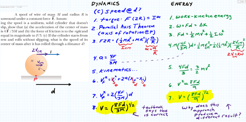

If the cylinder starts from rest and rolls without slipping, what is the speed of its
center of mass after it has rolled through a distance d?
torque = force x moment arm
work = change in kinetic energy
I got the correct answer (according to the textbook) using dynamics (steps 1-8 in blue as shown in the attached image).
I get a different answer using work-kinetic energy theorem (steps 1-7 in green as shown in the attached image).
Where am I going wrong?

As for your issues, there are several. Most are related to your step 4 where you make several faulty assumptions. Please type out your steps and provide your reasoning for each.
Edit: Note: Correct application of the work-energy theorem will give the correct result.
First, don't worry about quoting sections; simply reference the numbering shown in the image. This is a much more efficient approach v. cumbersome typing/equation editing. You should accommodate alternative presentation approaches; don't require others to adhere to your particular style. Be flexible.
I assume you are referring to step 4 for the energy analysis approach (go ahead and just state this). If this is correct, then for energy analysis step 4.
Left side: force x distance = mad, where a is the acceleration expression found, correctly from the dynamics approach. This is clearly shown in my work.
Right side of step 4: there are 2 kinetic energies: rotational and translational. (1/2)mv^2 is translational and (1/2)*I*w^2 is rotational. Omega (w) is shown as (2Vcm/R) as clearly shown. The rotational speed of a point on the rim is twice that of Vcm, so w=2Vcm/R (again, this is already clearly shown).
Wrong. That force is not the only force acting on the cylinder. Furthermore, the distance is wrong.
When you insert the acceleration from thd previous analysis you are effectively writing ##F=4F/3## or, equivalently ##4=3##, which is absurd.
Wrong again. Think about this one. Why would that be the case? You have not provided any valid reason to assume so.

Did you stop for one second to consider yourself at fault? Speaking of bedside manners, how do you think a doctor would react if the patient insisted that they be examined lying on their belly when the doctor asks them to sit up and on top has the audacity to claim that examination belly down is perfectly fine? This is a patient attitude problem, not a doctor attitude problem.
And no, your work is not as easy to follow as you may think. Particularly it is missing any form of supporting thought process spelling out what you are actually doing. Just listing equations does not convey the thought process properly. This is particularly the case when there are errors in the process.
