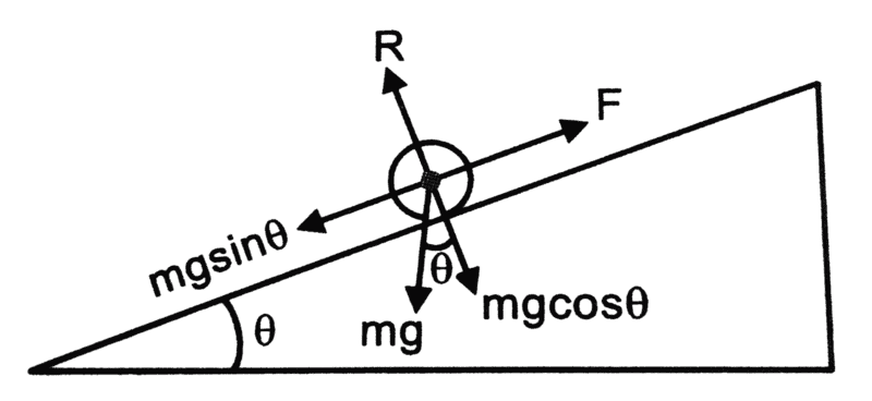

I am not able to derive the acceleration $a$ and velocity $v$. Please help me.
I derived time $t$ by dividing (2) by (1), but I am not able to derive (1) and (2).
t=\dfrac{\sqrt{\dfrac{2gs\sin \theta }{1+\dfrac{K^{2}}{r^{2}}}}}{\dfrac{g\sin \theta }{1+\dfrac{K^{2}}{r^{2}}}}=\sqrt{\dfrac{2s\left( 1+\dfrac{K^{2}}{r^{2}}\right) }{g\sin \theta }}
Here is the FBD of the rolling body
I have tried to derive acceleration and velocity but I am not able to. I took the resultant of linear/translational acceleration/velocity and angular/centripetal/rotational acceleration-and-velocity, and used them to work out how Newton's second law of motion works for this case. Please help me.

I have drawn the FBD for the rolling ball and I am trying to derive equations for the rolling ball from the Newton's laws like F=ma, f=μN, etc. The equations are:

An attempt would consist of using with Newton's laws in the context of the set up in the FBD so as to get equations specifically relating unknowns in the FBD.
You have not done that anywhere.
The motion you are interested in is parallel to the plane, so the first step is to identify forces which have a component parallel to the plane. Second step is to write expressions for those components, and the third is relate them to the acceleration via ##\Sigma F=ma##.

$$\begin{aligned}mg\sin \theta -F=ma\\ \Rightarrow mg\sin \theta -\mu R=ma\\ \Rightarrow mg\sin \theta -\mu mg\cos \theta =ma\\ \Rightarrow mg\left( \sin \theta -\mu \cos \theta \right) =ma\\ \Rightarrow a=g\left( \sin \theta -\mu \cos \theta \right) \end{aligned}$$
I think I am missing torque in my equation.
Yes, you are missing torque, perhaps because you have drawn F acting at the centre of the disc. Where does it act?
But there is also an error in the equations. You have assumed ##F=\mu_sR##. In what circumstance would that be true? Does that apply here?

R is the radius (your r). Since f acts at the point where the wheel touches the slope, and acts directly up the slope, its perpendicular distance from the centre of the wheel is R. Hence its torque about the centre of the wheel is fR. Thus ##fR=I\alpha##, where I is the moment of inertia of the wheel about its centre and ##\alpha## is its angular acceleration.
If a rolling wheel radius r turns through an angle ##\theta## then it moves distance ##s=r\theta## along the surface. Differentiating, we find, successively, ##v=\dot s=r\dot\theta=r\omega## and ##a=\dot v=r\dot \omega=r\alpha##.
