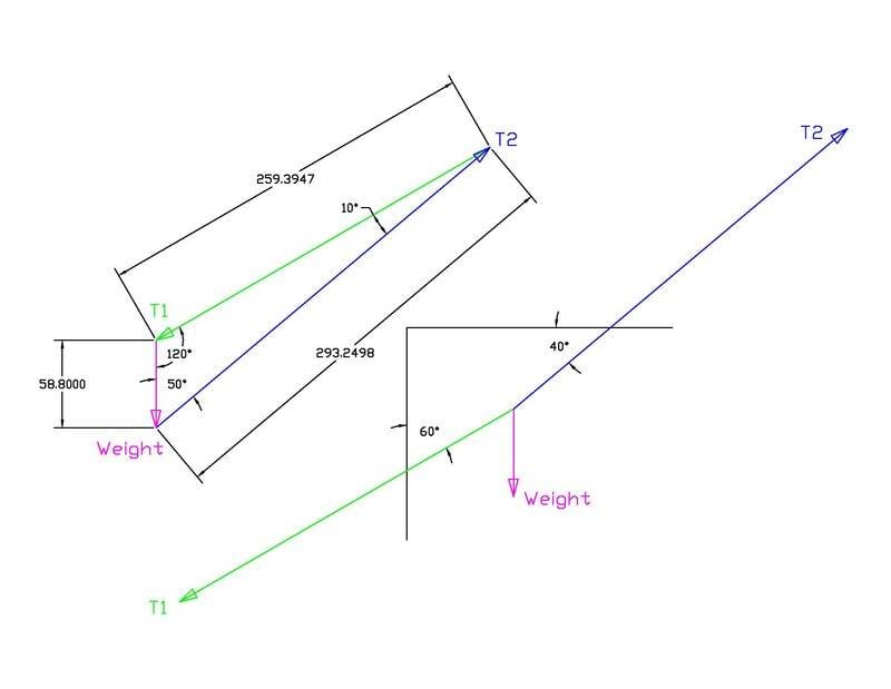

An object of a mass 6.0kg hangs from a rope as shown in the figure. What is the tension T1/T2?
Rope Tension Solutions
Please Help Me With This! I have tried so many different ways to answer it but I just cannot seem to find the right solution to get T1 and T2 for this.
1. Draw a free body diagram of the point on the rope at which the vertical rope is attached.
2. Demand the sum of all the forces be zero at that point.
Please use LaTeX to post your work and to explain what you are doing. To learn how, click #LaTeX Guide", lower left above "Attach files." If we don't know what you did, we cannot help you do it right.

We can only help you with some hints. Whenever you have forces acting at various angles like this, your first thought should be to decompose the forces into horizontal and vertical components.
This is what I did in my latest attempt.
Check your equation for the sum of the vertical components.
##T_2## is less than the weight of the object. That's impossible, given that the second rope is attached below the object and can't be supporting its weight.
Isn't it right that T1cos(60) + T2sin(40) = w?
Wait so you mean T1 must be greater than the weight and T2 is purely horizontal?

No. ##T_2## is supporting the object. ##T_1## is pulling it down. They are both pulling it sideways (in different directions). That's why a FBD for the object is a good idea.
Ok so, T1 pulls it left and down, while T2 pulls it up and right?
I am sorry if I am so confused, i'm very weak at physics.
I got a completely different answer when I changed sum of vertical components. T1 = 259.04 and T2 = 292.84. It feels so wrong.

It's not easy in this case to estimate the answer. I really wasn't sure what to expect. When I saw ##T_2 \approx 300N## (note that you should always include units in your answer), I thought you might have made a mistake. But, I did the calculation and got the same answer.
Sometimes the numerical answer to a problem is a surprise.
@litelboi, it's probably worth noting that you should make sure each answer has the appropriate number of significant figures. Or you can be penalised 1 mark in an exam!
The given data (m= 6.0kg, g = 9.8N/kg) have 2 significant figures. So your answers should be rounded to 2 significant figures, giving 260N and 290N.
You can usually get away with an extra significant figure, (answers of 259N and 293N). But you can’t justify 259.04N and 292.84N – you can’t get a precise result from imprecise data.

Why? You can see which of the two tensions is larger by looking at the equation for the horizontal components. We have $$ T_2\cos40^{\circ}=T_1\cos30^{\circ}\implies T_1=\frac{\cos40^{\circ}}{\cos30^{\circ}}T_2.$$Since ##\cos40^{\circ}<\cos30^{\circ}##, it follows that ##T_1<T_2.##

To avoid roundoff errors, one should also derive algebraic expressions for the tensions and substitute numbers at the very end.

It often helps to consider a special case variant of the problem. (This is one of the many advantages of working purely algebraically as far as possible. Never plug in numbers until you need to!)
Here's how you might have gone:
##T_1\cos(\alpha)+T_2\sin(\beta)=W##
##T_1\sin(\alpha)=T_2\cos(\beta)##
##T_1=T_2\cos(\beta)/\sin(\alpha)##
##T_2(\cos(\beta)/\sin(\alpha))\cos(\alpha)+T_2\sin(\beta)=W##
##T_2=\frac{W\sin(\alpha)}{\cos(\beta)\cos(\alpha)+\sin(\beta)\sin(\alpha)}##
##=\frac{W\sin(\alpha)}{\cos(\beta-\alpha)}##
To check, what would happen if you change 40° to 30°, so that the two tensions are in a straight line? There would be no way for the string to remain straight when a weight is hung on it.
Substituting the angle values 60° and 30°, nothing special happens, showing the above answer is wrong.
After correcting the error in the first line, you arrive at
##T_2=\frac{W\sin(\alpha)}{\cos(\beta+\alpha)}##.
Now plugging in those angles gives ##T_2\rightarrow\infty##.
