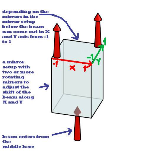

I am looking for some mirror setup where rotation one or more elements in the mirror setup will allow to shift the beam along its axis.
Two mirrors in a galvanometer scanner type setup work well for controlling the angle of the beam.
Rotating risley prisms can be used to only offset the beam without changing its angle but the possible positions are limited.
Dove prisms are great for rotating the beam along itself or rotate in a circular fashion if prism center is shifted.
But as for offsetting (shifting) a beam along its axis from a (-1,-1) position to (1,1) without changing the angle of the beam, I can't find any setup which involves a rotating mirror rather than shifting mirror. But I feel there may be something missing from my limited optics knowledge.

No not flip, but shift, or offset. Sorry for poor explanation.
Likes Shadow89
Thank you for the excellent drawing. Now I know what you are asking.
I will assume now, that what you call a "beam" is in fact one beam of light traveling parallell in a very small diameter cross section. I.e. a laser beam. Correct?
If this is the case, I would revert back to mirrors, as you yourself have suggested. Can you put a series of mirrors on a 45 degree angle and manipulate them using servo motors? This is what they do on Laser engraving machines.

I am looking for a method which will involve rotating (tilting) mirrors instead of offsetting (moving). The latter is just heavier and slower. For CNC it works great because speed is limited by cutting time anyway, allows to have very large offsetting and doesn't cause power loss. But not suitable for my use case as those are not an issue or requirements and speed is an issue. I just need to offset 10mm in both axis.
How big can the device be?
6x6x8 cm probably
wosoka said:
6x6x8 cm probably
If it weren't for your space limitations, I would suggest using a thick slab of glass of the appropriate refractive index (as high as possible).
You could use two in sequence, each rotating about its own axes. i.e. rotate slab 1 along x axis, rotate slab 2 along y axis, send beam along z axis.
You can cut the corners on the glass slabs to save some space.
Edit: Also you might suffer some abberation due to differential refraction of different frequencies of light, unless you are using a laser of one speciffic frequency. Just a disclaimer.

What will the calculation be for determining how much offset I will get given a slab refractive index, slab thickness, slab angle relative to beam variables?

I can say this is for pico video projection beam and I've tried laser scanners and while they are cheap (the "slow" ones) and easy to control, the distortion of the beam caused by angles of the scanner mirrors is hard to correct by undistorting the pixels in software and results in loss of resolution. Something which would be perfect would be to be able to offset the tiny projection beam without affecting its angle. I had some luck with a gantry system and stepper motors as well like in the CNC you linked to but it was just not fast enough, although close.

I think the same effect can also be achieved with two bounce mirrors attached together and rotating around a center point, yes? With an acrylic first surface mirrors would weigh a lot less.
