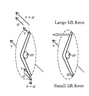

How do I calculate the rotation velocity of a boomerang assuming that the period is like 0.5 seconds ? Considering a boomerang made of 3 rectangles, with an angle
of 120 degrees between two of those rectangles... According to internet..we must consider a velocity of throwing and a velocity of rotation and I don't know how to calculate this second one..

I was thinking of calculating angular velocity and then use V = w.R where R radius but I get values a little bit too high

So we have the linear velocity of the boomerang as a given. Let's call that "v".
When we say that the boomerang is moving at v, it suggests that there is a point that is moving at v and that the boomerang is rotating around that moving point. That point has a name. Can you name it?
Likes RicardoMarques
I want to know this "a" assuming that the period is like 0.5... In the paper i read about it they call that velocity "a" rotation velocity... but is given i m/s and angular velocity is in rad/s, so I am kinda confused about this
I would have called it a "tangential velocity". It will be given by the rotation rate (in rad/s) multiplied by the radius.
If the radius is measured in meters, the resulting tangential velocity will be in meters/sec
