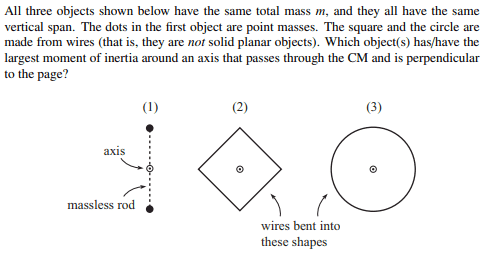

Rotational inertia of square about axis perpendicular to its plane
The discussion revolves around calculating the moment of inertia for a square and a circle about an axis perpendicular to their planes. Participants explore the moment of inertia for a circular shape, concluding it is given by I_z = mr^2 due to its constant radius. The challenge lies in determining the moment of inertia for the square, with suggestions to use the parallel axis theorem and consider the square's diagonal. It is noted that the moment of inertia of the square is less than that of the circle, leading to further algebraic exploration and corrections in calculations. Ultimately, the conversation emphasizes understanding the geometric relationships and applying the appropriate mathematical principles to derive the moment of inertia for both shapes.
member 731016
Please see below
Please see below
For this problem,
How do we calculate the moment of inertia of (2) and (3)?
For (3) I have tried,

Look at the Iz equation and think about what it means for each of the cases. You do not need to calculate anything.

Thank you for your reply @Frabjous!
I see what you mean for (3)! So
##I_z = \int r^2 dm##
##I_z = r^2 \int dm## (since a circle has a constant radius)
##I_z = mr^2##
However, how would I find the moment of inertia of the square?
Many thanks!

You don’t need to. Notice that the square fits inside the circle. What does this imply?
It implies that ##I_{square} < I_{circle} ## (since mass elements are either the same radius or closer than the circle) so ##I_{square} < mr^2##. However, how do we calculate the square's specific moment of inertia?
Many thanks!
Notice that each side of the square will have the same inertia. Take two points, like (r,0) and (0,r), and write down the equation of the line that connects them.

Rotate it by 90 degrees. Then just focus on the top horizontal segment. Multiply the result by 4.

That’s the idea. You know the diagonal of the square ##2r##, the rest you can figure out with that info.
Likes member 731016
You can do this without extra integrals. You can calculate the moment of inertia of one of the sides around the center by using the parallel axis theorem. You know the moment of inrtia about an axis going through the middle of the side. ##I=\frac{1}{12}ma^2## where m is the mass of one of the sides (1/4 of the total mass) and a is the side of the square. Then just add the ## m(a/2)^2## to get the moment about the center of the square (a/2 is the distance between the two centers). Once you know the moment of one side, you multiply by 4.
Likes SammyS, member 731016, erobz and 1 other person

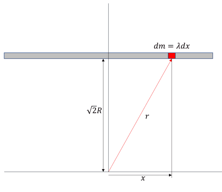

So far @erobz and @nasu I have got
## I = \int r^2 dm ##
## I = \int R^2 + x^2 dm ## Where ##2R## is the length of the diagonal which means that each side as a length ## 2(2)^{1/2} ##
$$ I = \lambda \int_{-(2)^{1/2}R}^{(2)^{1/2}R} R^2 + x^2 dx $$
## I = \lambda R^2 + \lambda \int_{-(2)^{1/2}R}^{(2)^{1/2}R} x^2 dx ##
Is everything so far correct?
Many thanks!

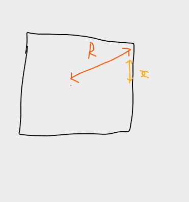

Check your algebra for ##r^2##. I do not get ##r^2 = R^2 + x^2##. Remember ##2R## is the squares diagonal. (that's not the only problem, but it's the first problem I see).
P.S. use the $ sign delimiters for the latex. It formats more readable with integrals and limits.
Likes member 731016

erobz said:
So the new integral is so far,
$$ I = \lambda \int_{-(2)^{1/2}R}^{(2)^{1/2}R} 2R^2 + x^2 dx $$
$$ I = \frac {M}{4(2)^{1/2}R} \int_{-(2)^{1/2}R}^{(2)^{1/2}R} 2R^2 + x^2 dx $$
Many thanks!
Callumnc1 said:
Are you saying that I can't take ##\lambda R^2 ## out of the integral since it is a constant in the space integral?
Many thanks!
You can't just take it out of the integral unchanged. How do you integrate a constant wrt x?
Likes member 731016
Many thanks!
The function for square root in latex is \sqrt{} Also, I wouldn't substitute for ##\lambda## just yet, its just more symbols to juggle IMO.
Likes member 731016
$$ I = \lambda \int_{-(2)^{1/2}R}^{(2)^{1/2}R} (2R^2 + x^2) dx $$
$$ I = \frac {M}{4(2)^{1/2}R} \int_{-(2)^{1/2}R}^{(2)^{1/2}R}( 2R^2 + x^2 )dx $$
Many thanks!
You need to put some parantheses inside the integral. Otherwise it does not make sense.
Likes member 731016 and erobz

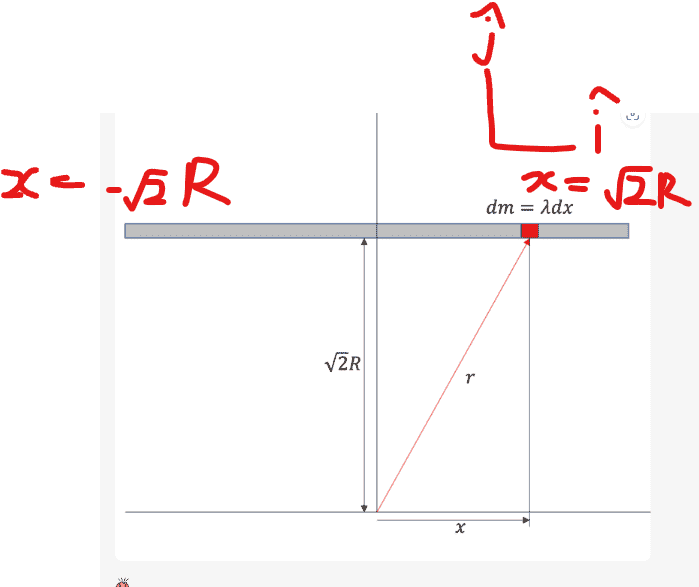

I got ## I = \frac {16MR^2}{3}## I don't think is correct though since ## I < MR^2 ##
Many thanks!
  • #33
Many thanks!
Not sure where all those ##R\sqrt 2## terms come from in your integral. Shouldn’t they be ##R/\sqrt 2##?

  • #35
Callumnc1 said:
Thank you for your reply @haruspex !
I'm not sure maybe? I got ##R\sqrt 2## from the diagram (courtesy of @erobz)
Many thanks!
I goofed. Should be ##\frac{\sqrt{2}}{2} R##

  • #37
Callumnc1 said:
No worries @erobz! What was the mistake?
Many thanks!
##a^2 + a^2 = R^2##
##2a^2 = R^2##
##\implies a = \frac{R}{\sqrt{2}} = \frac{\sqrt{2}}{2} R##
Just carless algebra...late at night for me.
Likes member 731016

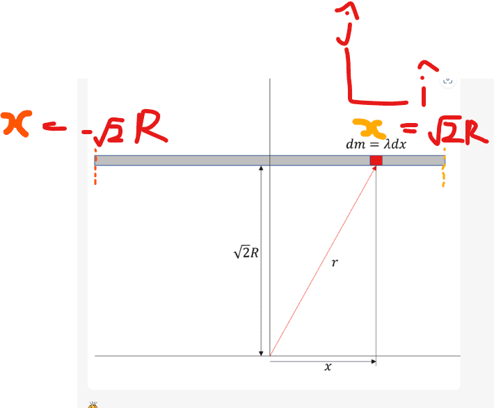

  • #38
erobz said:
##x^2 + x^2 = R^2##
##2x^2 = R^2##
##\implies x = \frac{R}{\sqrt{2}} = \frac{\sqrt{2}}{2} R##
No worries! We all make algebra mistakes! Thank you for your reply @erobz!
So, I'm just trying to understand how you got ## y\hat j = x\hat j##. I have drawn a grey square below.
I'm trying not to use circular reasoning, but did you get ## y\hat j = x\hat j## because ##\vec r## will always form a right isosceles triangle since it is a square so ##\theta = 45##?
Many thanks!

  • #40
haruspex said:
You should be able to work that out yourself. R is the distance from the centre of the square to one corner. How far is it from the centre of the square to the centre of one side? If x is a displacement along a side from its midpoint, what is the range of x?
Thank you for your reply @haruspex!
I was trying to consider cases where ##\vec r ≠ R## for when the position vector is pointing somewhere along to the mass element on the sides not to the corners.
When ##\vec r = R##, I can see that since it square then each side of the right triangle will have equal sides of length ##x##.
I think the range of x for that case would be from ##0## at the midpoint to ##\frac {R}{\sqrt{2}}## at the centre of one side.
Dose this special case hold for ##\vec r ≠ R##?
Many thanks!

Many thanks!
Why do you want to solve this using vectors? It's straightforward using scalars and the parallel axis theorem.
Edit: rereading your post, I don’t understand it. How are you defining ##\vec r## and x?

The vector ## \vec{r}## varies, in both magnitude and direction, but for that horizontal segment It will always have the form:
$$ \vec{r} = x ~{\hat i} + \frac{\sqrt{2}}{2} R ~{\hat j}$$

  • #44
So you are going to have to change the integrand to what it should be, and your limits of integration.
And to echo @haruspex, do it using @nasu approach (without integration) as a concomitant method.
Sorry, let me try to explain it better.
(sorry about the tilted coordinate system, the ##\hat i## axis should be horizontal and ##\hat j## axis should be vertical)
##\vec r_1 = \sqrt {x^2 + y_1^2} ## since it has a ##x\hat i## and ##y_1\hat j## component. However since ##y_1 = x## in this special case then ##\vec r_1 = \sqrt {2x^2} = R ##
For this other vector their y-component is not ##x##
##\vec r_2 = \sqrt {x^2 + y_2^2} ≠ R## (cannot equal R since ##\vec r_2 < \vec r_1 ##)
##\vec r_3 = \sqrt {x^2 + y_3^2} ≠ R##
So what I was saying is that we should consider the general case where,
##\vec r = \sqrt {x^2 + y^2} ##
Where x is a constant equal to ##\frac {\sqrt {2}}{2}R## and y is a variable position vector component in the y-direction.
However, if we choose a different coordinate system, such as what @erobz has done in post #43
Then now y a constant equal to ##\frac {\sqrt {2}}{2}R## and x is variable position vector component in the y-direction.
I think the confusing thing about this problem is choosing the right side to find the moment of inertia for and defining the right coordinate system. What do you think?
How would you solve this using the parallel axis theorem out of curiosity?
Many thanks!

  • #46

  • #48
