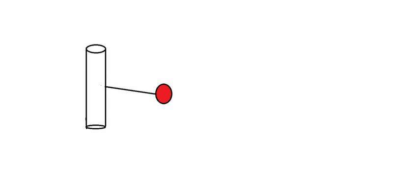

I am very late...but i think that it is pretty simple...angular momentum is conserved in the tetherball system...there is no net torque...
mVR=mvr.
V = vr/R
say at R = r/2
=> V = 2v.
I think the problem u say is in the conservation of energy.
Initial Kinetic energy =Ki= (1/2)m*v^2
Final Kinetic energy = Kf=(1/2)m*V^2= (1/2)m*4v^2=4*(Ki).
Whoa...how did that happen?...
U are forgeting the fact that there is a centripetal force caused by the pulling rope acting on the ball..this force happened to pop up simply because of the velocity we initially applied...
There is some work being done on the ball when it is pulled inward by this force.
We know centripetal force Fc = mV^2/R.
Now V is a function of R as V = m (v^2 r^2/R^3)=(m*(vr)^2/R^3)
Work done by this centripetal force= W = ∫Fc.dR (from r to r/2)
so we will get V = m(vr)^2*∫R^-3dR=-(m(vr)^2)*(1/2(R^2))
applying the limits we get W = (1/2)[(m v^2 r^2 /r^2) - (m v^2 r^2/(r/2)^2)
= -3 ((1/2)*m*v^2) = -3*Ki..
Wow...and it perfectly fits...!
Ki = Kf + Work done by the centripetal force...
So as u see both angular momentum and energy are conserved...You simply were not considering the complete energy equation...The energy conservation is for the net mechanical energy of the system and not just the kinetic energy...
The same caculations would be true even if u did it with angular velocities and Kinetic energies...I just did the simplest way of calculating it...
  • #57
No, your analysis can't be correct. There is no energy input after the ball has been given the first impulse, so we cannot end with more energy than we started with.
The question has already been correctly answered: the rope does no work on the ball, since there is no motion in the direction of the length of the rope (contrary to what would happen if somebody was pulling the rope inwards through a hole). The ball's KE, and therefore its speed, stays constant. The ball's angular momentum decreases, but the angular momentum of the system ball + pole + Earth stays the same.
If the ball continues spiralling round the pole until it crashes into it. If the ball were a point mass, it would be moving directly towards the centre of the pole at the moment it crashes into it, so at the end of the spiral it has zero angular momentum.

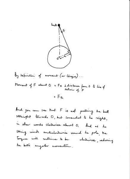

  • #62
We started with rotational mechanics not to long ago, and sure enough a similar problem arose in our class, though our teacher simply told us the reason, without letting us work our brains on it.
The thing is, even though the tension in the string is perpendicular, the hinge reaction force by the pole is not, and hence this "non-conservation" of energy, again bringing us to the same conclusion as the rest of the people here, the pole AND the Earth too have to be considered in the system.

  • #65
The thing is, even though the tension in the string is perpendicular, the hinge reaction force by the pole is not, and hence leads to this increase in energy, again bringing us to the same conclusion as the rest of the people here, the pole AND the Earth too have to be considered in the system.
There can be no increase in energy! Consider the whole system: ball, pole, Earth. We are using a frame of reference in which the Earth is stationary. By definition, the Earth has no KE in this frame. Nor does the pole. The ball cannot gain KE, since there is nowhere to gain it from.
When considering the whole system, it's clear that:
1. Angular momentum is conserved. The ball loses angular momentum, the Earth gains the same amount. Since the Earth is so massive, we don't notice its change of momentum.
2. Energy is conserved. The ball loses an immeasurably tiny amount of KE to the Earth. I'm not going to do the calculations: if somebody else wants to they're welcome! For all reasonable limits of accuracy, the ball's KE remains constant. This means that the speed of the ball (not its velocity!) remains constant.

once more:
1. Angular momentum of the system Earth + pole + ball is conserved. Ball transfers angular momentum to Earth: ball's angular momentum decreases.
2. Torque is acting since the centre of rotation of the string is not the centre of the pole.
3. KE of the ball cannot increase because there is no energy source external to the system.
Look at the link to http://www.lhup.edu/~dsimanek/scenario/insight.htm#skater that I already posted.

I'm not so good at rotational dynamics - if the pole has a thickness why is angular momentum for the ball not conserved? Please explain carefully?
And btw: Nice thread =)

Do you recall how to calculate the torque (or moment) of a force about an axis? [Force x perpendicular distance from axis to line-of-action of force]?
Now, unbalanced torques acting on things make them change their angular momentum. If this is intuitively ok, then fine. If not, then we'd need to explain exactly what angular momentum means. [Actually, it's defined very much like torque, but with velocity instead of torque.] And then we'd need to do some vector algebra. Let's assume it's intuitive!
We need to choose a fixed axis about which to take the torque. The centre of the pole is an obvious axis to choose. Now. because the string is coming off the side of the pole, it's not pulling the ball straight towards our axis. Indeed, there'd a torque on the ball, according to our definition, of Fa about the axis, if F is the force and a is the pole radius. So therefore the ball's angular momentum keeps changing (decreasing).

hmm okay I think I see it, when I imagine the pole to be very thick. Though I'm not sure, can you draw how the torque vector looks?
Just put it on the figure I attached.
Does this mean that the angular momentum is conserved in the frame of the point of application on the line? And that then means that it is not conserved for the ball?
What is the criteria that angular momentum is conserved for the ball? Must the rotation be around the center of mass for the pole (which its not) and why?

Hallo aaaa202. Does this make sense?
The torque vector (since you ask) is into the page; if you're into vector algebra, torque, G is defined by G = r \timesF in which, in this case, r is the displacement vector from O to the ball.
