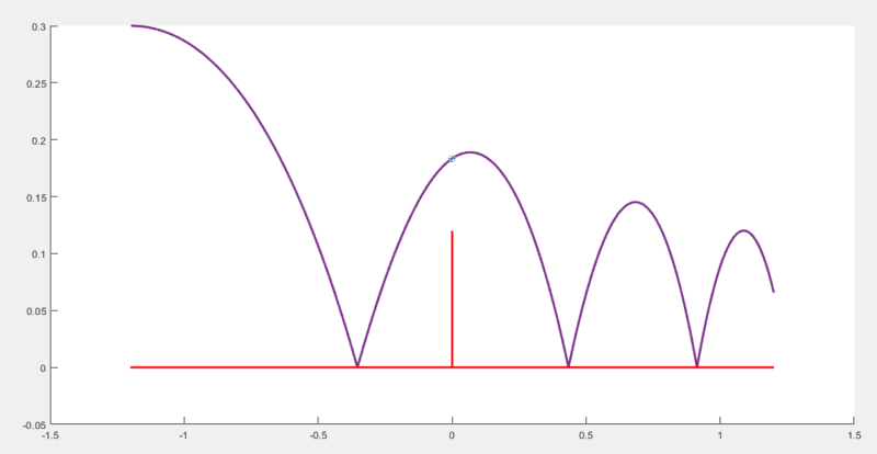

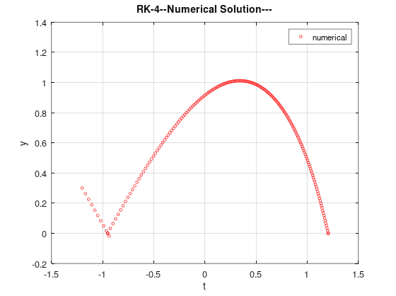

The solution is plotted below
The thing I'm having problems with is the error calculation of the main RK4 process. From above I know that:

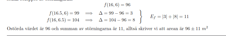

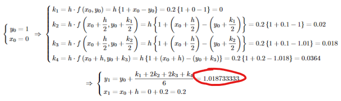

Does it help showing you this part of the lecture slides? I believe math is quite a universal language, if I can fill in the details.
This example from my teacher finds ##y(0.2)## with ##y'=1+x-y##, given ##y(0)=1##
First with ##x_0=0## and with step length ##h=0.2##
Then with the step size ##0.1## (##h/2##)
Finally she concludes that the truncation error is ##|y_{\text{at }x=0.2}(2h)-y_{\text{at }x=0.2}(h)##
(Sadly this is the best I can show you to prove my point)

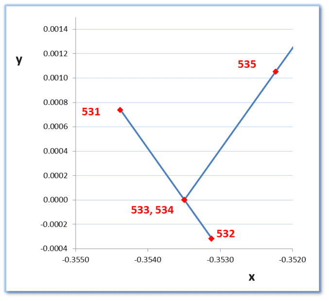

I still wonder about your algorithm to locate ##y=0## points -- in connection with the notion that your real concern is the global error.
I wonder if it isn't equally accurate to take a single step of size ##y_{n-1}/|\dot y_{n-1}|## instead of ##h## if a step size ##h## causes ##y_n < 0##.
It certainly would be a lot more efficient !

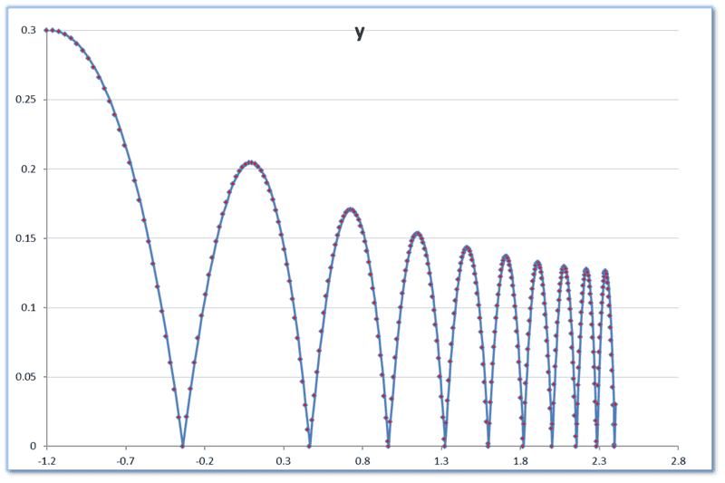

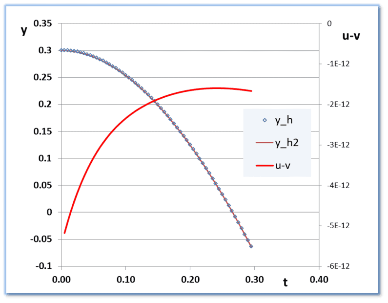

Lack of code made me do Good old Euler
Step size 0.01
Tedious but fun. Would be nice to compare the ##x## where ##y=0##
:smile:

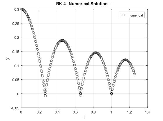

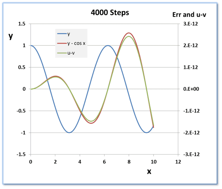

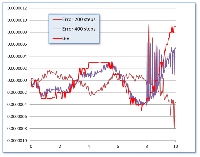

Coming back to that global error. Here is an RK4.F90 including a simple test: ##\ddot y = -y, \ y(0)=1, \dot y = 0## from x=0 to 10. The answer is a cosine. Ran it with 50 steps, 100, 200, 400. Error ##\equiv y(x)-\cos(x)## plotted. Clearly 50 and 100 steps is not good enough (although all within ##10^{-4}## :smile:).
200 and 400 steps are more interesting. Some up and down and disruption after x=8. Bright red line is ##u-v##, i.e. ##y(+h)-y(+h/2+h/2)## , the local truncation error estimate.
As you can see, a lot is going on. And a lot can go wrong -- which Murphy states it will.

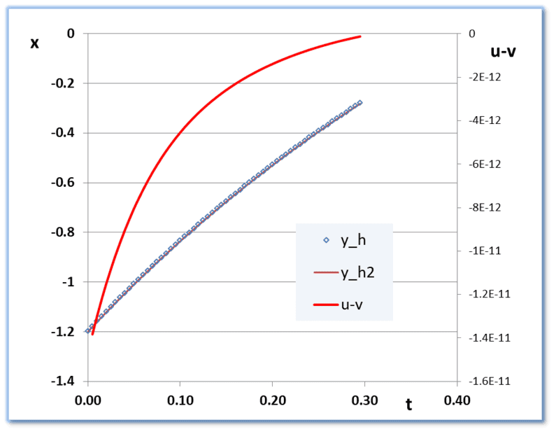

Disclaimer: I hope Excel cosine calculation is not the culprit. Burkardt f90 seems ok (but I have to jump 45 years from my fortrran IV and VAX fortran to nowadays fancy IDE so :rolleyes:).
[edit] Spikes are artefact: turns out a few variables were real instead of real*8 (double precision). Fixed, and all error plots are completely smooth. And ##u-v## is about 94% of the error.[edit 2] have to withdraw this. ##u-v## does not follow from comparing two runs with e.g. 4000 and 8000 steps
Blue and red lines in plot below are all right. Green line compares ##y## from 4000 steps with corresponding (but not exacly equal) ##y## from 8000 steps. Since latter are 24 times closer to the cosine, green line is 15/16 of red line.
Sorry for the distraction.

Haha, nice! You asked for x-values for comparison for fun, here's what I get using the initial conditions given in the top post: (for the three bounces before ##x=1.2##)
-3.53496e-01 4.3385e-01 9.1342e-01

To directly translate this method from what we call it in my language would be "distrubance counting". I've been trying to find the English name for months, haha!
The principle is. Let's say you have a function ##f(x,y,z)## where ##x, y, z## have insecurities ##\pm 1%## as an example What you do is, try each combination: ##f(x\cdot 1.01, y, z)##, ##f(x, y\cdot 1.01, z)##, ...,
##f(x\cdot 0.99, y, z)##, ..., ##f(x\cdot 1.01, y\cdot 1.01, z)##, and so on.
If you compare the differences from ##f(x,y,z)## for each value, an estimate of the global error is
\sum \left|\Delta \right|
The given values that have insecurities are ##m##, ##k_x## and ##k_y##. I have multiple numerical methods in my code: Runge-Kutta 4, interpolation, bisection method (used for a later part of the code, where the velocity is unknown but instead that ##x(0)=0.3##). I'm wondering if the meaning of this method is that I should simply watch how the output for all the combinations change with all those combinations disturbed at the input level, or if I also need to fiddle around with disturbing outputs internally (disturbing the output of the interpolation before moving on to the bisection method for example). To me that doesn't really seem like what I should do, but discussing the problem with some others suggested that I might need to do that.

A numerical form of error propagation ? ##\sum|\Delta|## is the pessimistic variety (assumes full correlation, whereas ##\sqrt{\sum\Delta^2}## assumes independence).
By the way, you mean ##\pm 1##% and not ##\pm 1##, right ?

My post #8, second picture is worrying me a great deal : ##u-v## (as in MIT 7.17) can be near zero while the errors themselves have big spikes. I want to find out if this is really true or I make a mistake somewhere.
Don't know about MATLAB, but fortran double precision is about 15 digits. So ##h^5## is way down the numerical noise if ##h\approx 10^{-7}## .

Beg to differ. With step size 5e-4 (as in post #18) we get a first ##y<0## at step 532 with ##y=##-3.16e-4. ##\dot y\approx## -2.1 so the Newton step size is -1.5e-4 . Such a step (number 533) approximately doubles the amount of significant digits and takes us to ##y=##-7e-8. I had ##|y|<##1e-14 as criterion so it took another step (size -3.4e-8, still backwards) to double the number of significant digits once more and end up at ##y=##-4e-15. Set ##y\equiv 0## there and flip ##\dot y## so the next step can be forward with size 5e-4 .
Pretty effective way to end up at '##y=0##' with only two steps . Would there even be a better way to 'find that right step length' ?
step sizetxydot y
531​
0.265500000​
-0.354382029​
7.3759908E-04​
532​
5.0000E-04​
0.266000000​
-0.353117709​
-3.1642531E-04​
-2.108049​
533​
-1.4999E-04​
0.265850010​
-0.353496871​
-7.1403408E-08​
-2.109160​
534​
-3.3862E-08​
0.265849976​
-0.353496957​
-3.6842425E-15​
-2.108684​
535​
5.0000E-04​
0.266349976​
-0.352233364​
1.0526812E-03​
2.105362​
bremenfallturm said:
why this kind of reverse-stepping thing works. How come the condition "until |y| doesn't decrease anymore" work?
Ha, stepping backwards works because the expressions are just as valid for ##h<0## !
And ##|y|## stops decreasing once machine precision is reached. But counting on that is not good practice, so I changed it to requiring ##|y|\le ##1e-14.

Step size 5e-4 gave me local truncation errors of machine precision (#32), so I tried again with step size 5e-3.
Forget about the bouncing, just integrate from 0 to t=0.3 in 60 steps.
What y do you compare to do that? And how do you find out where in the "solution" matrix the new y is stored?
Gives me 61 vectors ##(t_n,x_n,y_n,\dot x_n, \dot y_n)\quad ## n = 0 to 60
At each of these points ##n## I also do a two step RK4 with step size 2.5e-3.
That gives me a vector ##(t_{n+1},x^*,y^*,\dot x^*, \dot y^*)\quad ##
So I have (in MIT (7.17 notation) ##y(x+h)## and ##y(x+h/2+h/2)##.
And therefore an estimate of the local truncation error for both horizontal position: ##x_{n+1} - x^*## and vertical position: ##y_{n+1} - y^*##.
In pictures:
x(t) is almost a straight line and y(t) is almost a parabola :smile:.
The red lines show the local truncation error estimates (I dubbed them 'u-v' somehow) All negative.
Even a pessimistic global error estimate (just add absolute values) yields a maximum uncertainty in ##x## and ##y## after 54 steps of
about 2e-10. Consistent with the 9 significant digits above.
