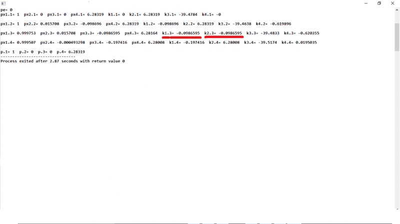

Hello, thanks for your interest in may help me, i appreciate it, really.
My question is, I've wrote this code to solve an physical EDO system. But for some reason it copies the element k[1][3] at k[2][3].
After i call the initials elements the code becomes:
Help me please, i have no more ideas !

You may debug the program and observe how each variable gets changed in every step.
I think this line
Code:
k[j][l]= f[j];
may start the problem.
E.g j=1, l=3 the k1,3=f1=px3,3
j=2, l=3 the k2,3=f2=px4,3
Looking up further above, you will see
px3,3 = px4,3
I may overlook something though.
