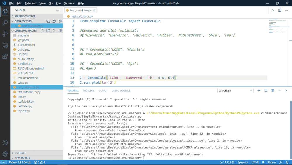

I am doing a cosmological work and I need to run a code form this github page
https://github.com/ja-vazquez/SimpleMC
I download the whole repository as .zip file and I inserted into my desktop. Then I opened it through vs code and this is how it looks like
The problem is that, when I run `test_calculator.py` or any other file I get an error
Python:
  Initalizing nu density look up table... Done
    Traceback(most recent call last):
    File "c:\Users\Arman\Desktop\SimpleMC-master\test_calculator.py", line 1, in <module >
    from simplemc.CosmoCalc import CosmoCalc
    File "c:\Users\Arman\Desktop\SimpleMC-master\simplemc\__init__.py", line 32, in <module >
    from . import analyzers
    File "c:\Users\Arman\Desktop\SimpleMC-master\simplemc\analyzers\__init__.py", line 2, in <module >
    from .MCMCAnalyzer import MCMCAnalyzer
    File "c:\Users\Arman\Desktop\SimpleMC-master\simplemc\analyzers\MCMCAnalyzer.py", line 10, in <module
    from mpi4py import MPI
    ImportError: DLL load failed while importing MPI: Belirtilen modül bulunamadı.
I guess there's something wrong with the file system. Such that the code cannot use ìmport` properly. But I don't know how to fix it. I am using Windows 10.

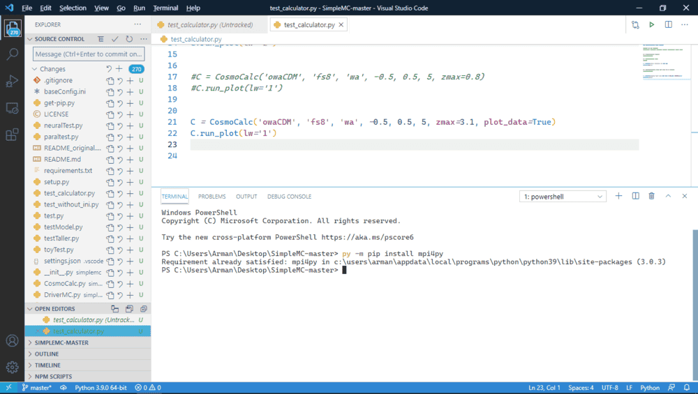

Let me ask my question in a different way. How you guys download and run this test_calculator.py to work ?
Arman777 said:
I have already downloaded that package.
Downloaded how? If you didn't install it, either using pip or whatever Windows installer the package's authors provided, it's probably not installed in a way that is usable.
check this out

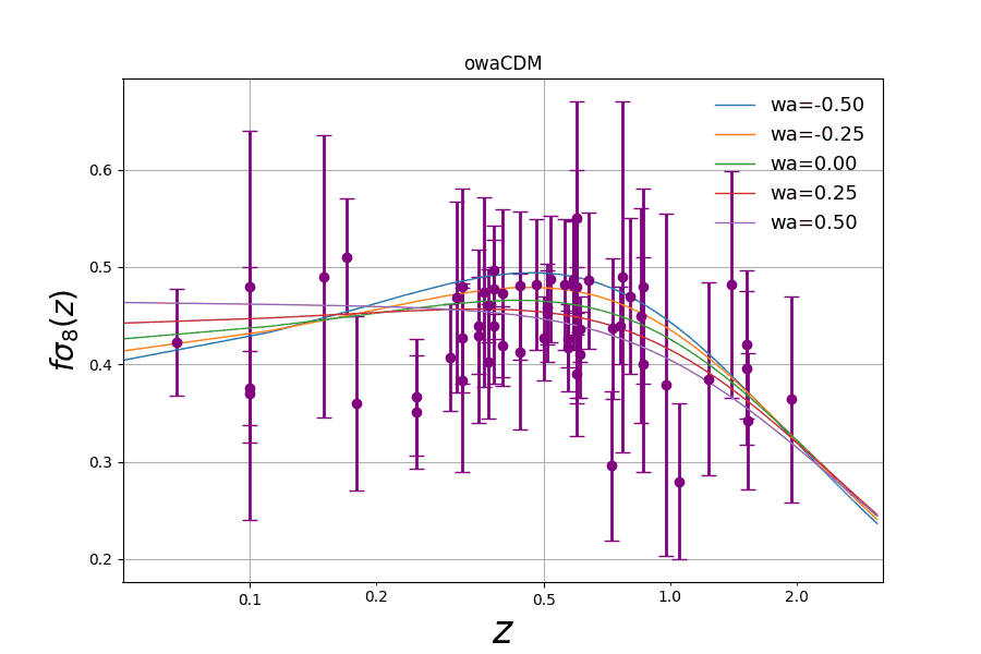

On my Ubuntu laptop, I could run the file test_calculator.py properly. It even gave me this graph:
I cloned the repo using git clone https://github.com/ja-vazquez/SimpleMC.git --branch master --single-branch
In order to run the file, you need two packages: mpi4py and deap. You have already installed the former. Have you installed the latter?

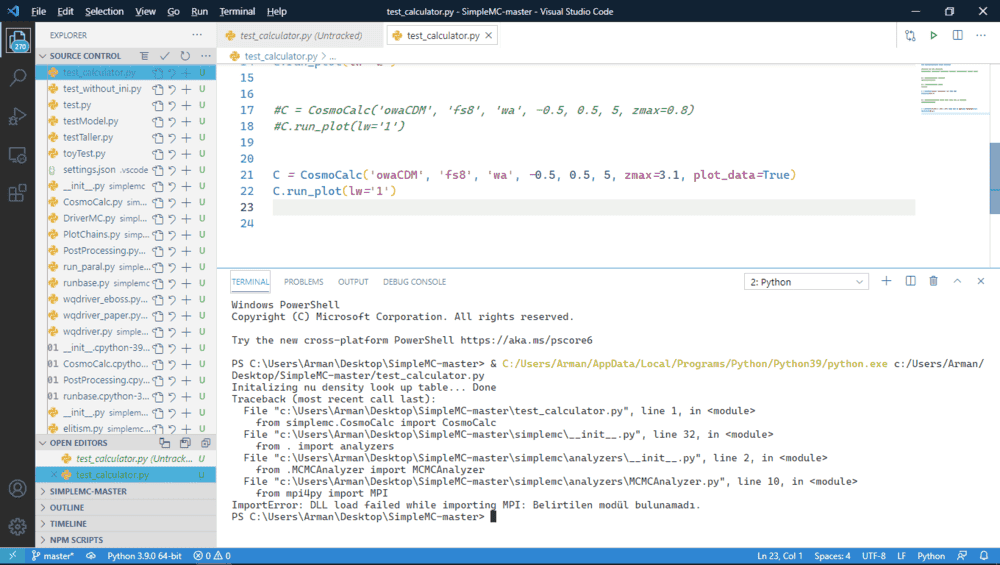

Yeah I did.. I guess its due to using windows or VS code file system. I guess I need to use something else.
I don't think that the file system is the problem. The library mpi4py needs some other non-python dependencies. On Ubuntu, I had to install libopenmpi-dev before installing mpi4py. I thought that this problem is unique to Ubuntu, but a Google search using the keywords importerror dll load failed while importing mpi the specified module could not be found windows shows that you are not the only one facing this problem.
