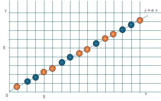

I let EXCEL calcuate up to n=40 for approximate values of sqrt(2) and e.
Without losing generality we can make ##|\alpha|<1## by adding/deleting even numbers. For example ##\pi-4## instead of ##\pi##, ##\sqrt{2}-2## instead of ##\sqrt{2}## work. ##\alpha## and -##\alpha## are equivalent in the behavior with opposite siganure, so further we can reduce ##0<\alpha<1##. Please find the graph showing for each k on x axis, +1 or -1. We find that + and - are almost same in number which shows sum =0 would take place infinite times though it is not proved yet.
