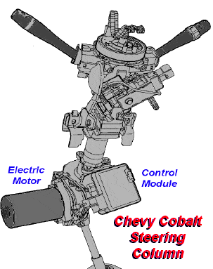

Does anyone know if there's a backup linkage between the ball nut and the steering pinion so that the nut doesn't lock up the rack if the power goes out?
Thanks.

No specific brand. I did see that BMW uses a ball screw, while some other manufacturers use a worm gear on the steering column. The lock-up behavior should be roughly the same for both.

I have a 2003 Saturn Ion with electric power steering. At about 120,000 miles, the power steering went out but it was still drivable. It was just more difficult to turn. However, I'd say it was less difficult than some of the older, hydraulic power steering vehicles I've driven where the power went out. The power steering came back on after I turned the car off and re-started the car and it seemed fine for a while. Every once in a while it would lose power steering so I'd just continue on and it would work again the next time I drove it. At around the same time, GM decided to warrenty the power steering for the life of the car so I had it repaired for free.

I replaced a defective rack and pinion recently in an electric assisted system mounted to the steering column inside the car, and with the ignition off it had no assist but was not very difficult to turn sitting still on smooth cement or blacktop. The mechanical advantage of the pinion ratio makes the tires easier to turn but then you have to turn the steering wheel further to make the tires turn a given amount compared to many hydraulic units which provide a greater assist to a higher ratio pinion, and are therefore much harder to turn without the assist.

Good to hear. So then I assume that there must be a safety release or backup linkage somewhere.
