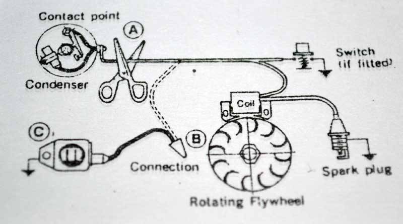

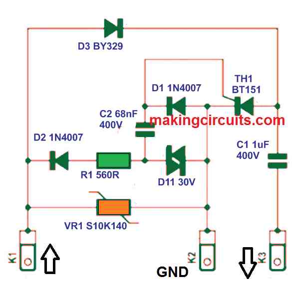

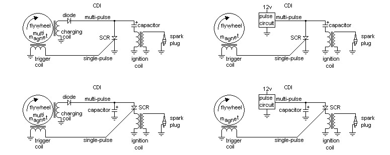

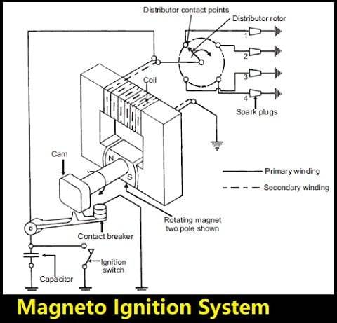

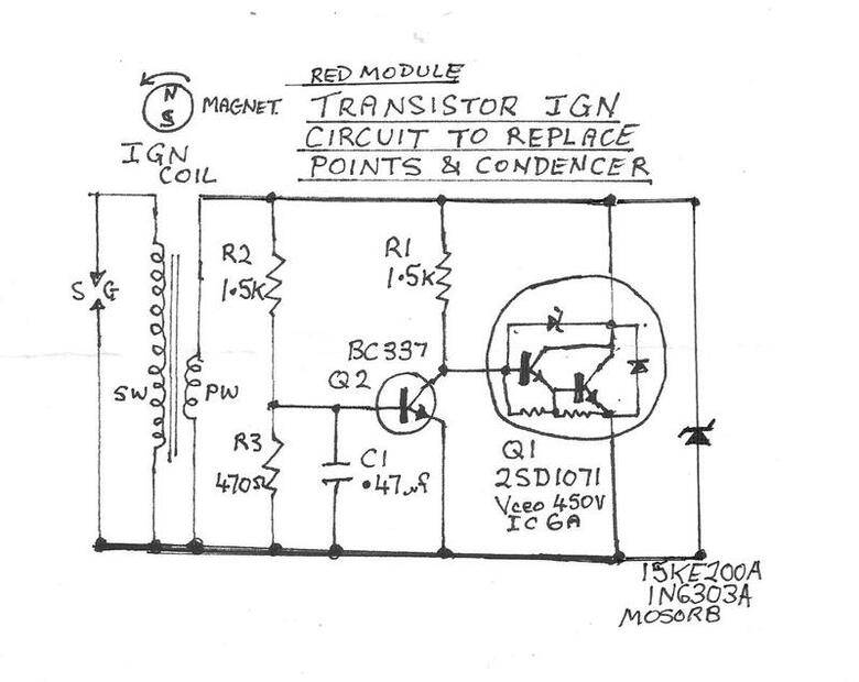

For interest, and to help in testing, I’d like to find a schematic for small engine ignition coils - the type with two magnets on the flywheel passing by the core.
As above. As I understand it, there is a charge coil and a trigger coil, and some circuitry potted in together.
Google: magneto ignition system diagram
jack action said:
How does the following link NOT answer your question?
https://www.google.com/search?q=schematic+for+small+engine+ignition+coils&udm=2
Slightly brusque, I assume from too many posters not bothering to research first. I didn’t put enough in the OP, sorry.
I meant to say I’d already searched, and found much the same results. Almost all of those depict external points or CDI units. The closest one features a third ‘salient’ pole for the trigger coil.

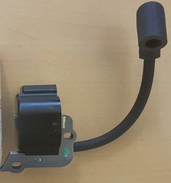

The type I’m interested in is like this, just two poles, a ‘kill’ terminal, and is set against two magnets on the flywheel. These seem to be more common on small garden stuff, but don’t seem to feature in explanations:

@jack action I can’t see, from those links, an equivalent circuit, unless I’m missing something. I’m looking for two magnetic poles and three connections, kill, earth and spark. The positions of the poles are critical for defining charge and trigger, for ignition timing, and I think there’s some significance in the presence of two magnets, not one, on the flywheel.

The original question was about the internals of this, very common, type of ignition coil, and whether there’s any chance of electrically testing same to confirm dead.

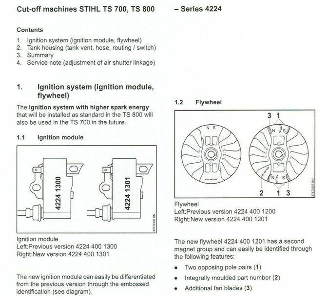

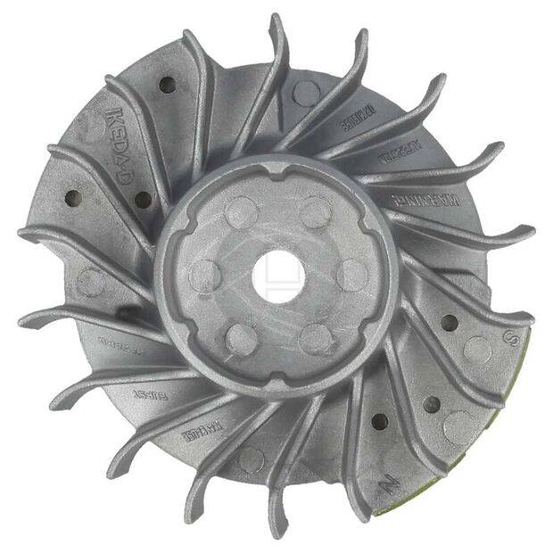

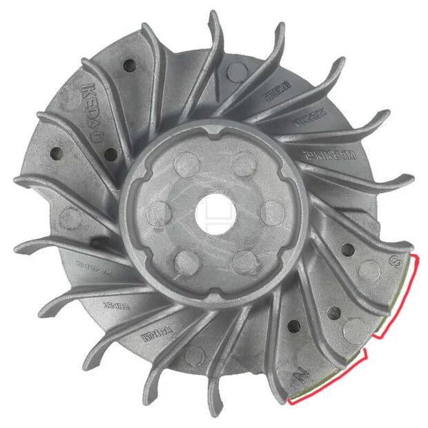

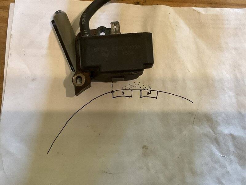

Back to the coil, this is a sketch of the flywheel at TDC, roughly gauged with a screwdriver down the bore. The letters ‘N’ and ‘S’ are cast into the aluminium over the magnets, so I assume the field is as drawn. Since rotation is anti-clockwise, it looks like the spark will occur after TDC.
To be clear, there are no other components, points, battery, CDI box, etc., other than the spark plug itself. The spade terminal is simply switched to chassis to kill the spark. Chassis ground is from the core mounts.
  • #31
To be fair we had to wait until post #27 to know that we were dealing with a Stihl HS45. Stating as much information as possible in the first post helps everybody give quality answers quickly.
I'm not an expert on ignition systems and never really worked with small engines, but what baffled me was the two magnets thing. I don't see what the second magnet does. Once I knew the company name, a new search brought me the following images, the first one should be your flywheel where it is not clear that there are 2 magnets, and the second one comes from another machine of the same company that shows that a single-magnet flywheel - along with its ignition module - is replaced by a 2-magnet flywheel. The magnets are 180° apart and the poles are not facing the same direction. The only purpose seems to be giving a higher spark energy.
I also found this:
The use of two magnets in Stihl saw engines offers several advantages. Firstly, having two magnets ensures a more consistent and reliable spark. If a single magnet were used, there could be variations in the strength of the spark generated, leading to inconsistent combustion and potential engine performance issues. Having two magnets helps to eliminate this problem by providing a more balanced and robust spark.
Secondly, the use of two magnets also provides redundancy. If one magnet were to fail or become damaged, the other magnet would still be able to generate a spark. This redundancy is crucial in ensuring that the engine keeps running smoothly, even in the event of a magnet failure.
Additionally, the arrangement of the magnets on the flywheel is carefully designed to optimize their performance. The magnets are strategically placed to ensure maximum magnetic flux and spark generation. This design consideration helps to further enhance the efficiency and reliability of the ignition system in Stihl saw engines.
This seems to mean both magnets are near TDC. Otherwise, how else could one magnet replace the other one in case of failure? Below, they even specify "two or more magnets" which makes me even more baffled; If they are not all near TDC, where are those magnets?
Different models of Stihl chainsaws utilize varying numbers of magnets in their ignition systems. The number of magnets can impact the efficiency and power output of the chainsaw. Chainsaws with more magnets generally produce stronger, more reliable sparks, resulting in improved fuel combustion and overall engine performance.
For instance, Stihl's higher-end professional chainsaw models, such as the MS 661 or the MS 880, typically feature systems with two or more magnets. These chainsaws are designed to handle heavy-duty tasks and demand a high level of power and performance. The additional magnets in their ignition systems ensure a more consistent and powerful spark, enabling them to cut through large logs or tough materials with ease.
Here, they sell a conversion kit from mechanical to electronic trigger module and specify:
The ignition trigger replaces points and the condenser on most chain saws having just two magnets [north and south]. If a flywheel has more than two magnets, then the ignition chip trigger will not work.
I understand that they are talking about a single magnet with two poles when specifying "two magnets [north and south]". But it doesn't tell me how models with multiple magnets work.

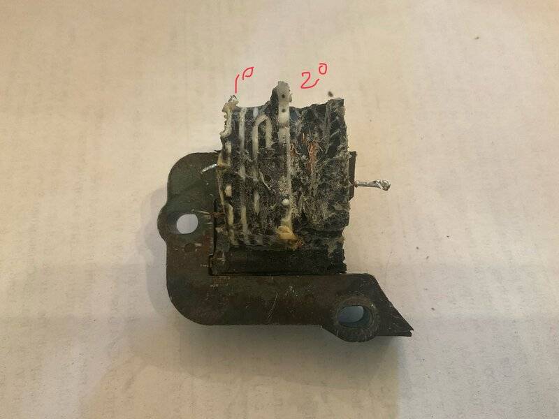

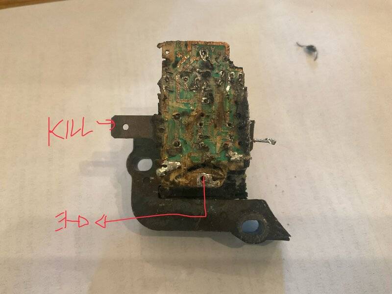

I hope that, having the opportunity now, you open the useless coil, dissect it, and you understand its functioning parts.

The Stihl HS45 happened to be on my bench at the time, and triggered the question, but as I say above, this system is ubiquitous in my experience. Even on four-stroke mowers, where it must be a waste-spark system. The exact machine didn’t seem relevant, only the description given in my first two posts. I will concede it would have made a starting point for research, though.
There’s a grumpy response to my comment on grumpiness! Built up over a few years of seeing it directed at many posters. Not to be taken personally. Please don’t let us argue about that.
From Jack’s post, I see that the two magnets might be for redundancy, so we could analyse the circuit using only one, for simplicity. That photo looks much like my flywheel - I’ve tried to emphasise the two (doodling on pics is a very Jim Hardy thing to do!)
So it looks like one way to find out the answer is to depot the old coil. It’s a hard, black resin, presumably epoxy. Some say methylene chloride to dissolve, some say heat, some say don’t bother. What’s the best way to do it?

To me, this is a single magnet, one with two poles, north and south. Here is another representation where the single magnet is more obvious:
Of course, the ignition module contains electronics that replace the contact breaker and capacitor.

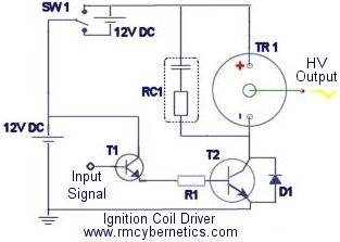

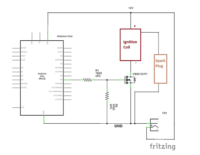

Remember when in post #2, I gave you a link to a Google search? Well, here is what I found out from that link that is relevant to your questions:
From https://www.electroschematics.com/555-ignition-coil-driver/ :
From https://forum.arduino.cc/t/need-help-to-drive-an-ignition-coil-with-a-vb921/350723 :
From https://www.rmcybernetics.com/science/diy-devices/diy-ignition-coil-driver :
From https://makingcircuits.com/blog/universal-motorcycle-cdi-circuit-capacitor-discharge-ignition/ :
These all represent the type of electronics that might be present in your ignition module, which also incorporates the coil as well. They, of course, work with steady 12V power, but your circuit must work with the induced power by the magnet, which may also be the positioning signal at the same time. In post #31, there is clearly an electronic module that exists to replace a breaker/capacitor set-up for any mechanical setup. Stihl just incorporated the module with the coil. By adding the term "batteryless" to the Google query, I could find:
From http://gpzweb.s3-website-us-east-1....AndCoilWiring/IgnitionTypesAndCoilWiring.html :
From https://www.electro-tech-online.com/threads/pointless-magneto-internal-schematic.144306/ :
This circuit can be constructed to replace the ign points in a magneto ignition system. Ive fitted it to my Victa 2stroke mower. You just remove the points & condencer, & fit this circuit in its place on the ign coil. Depending on the polarity of the pulse from the coil, the unit may have to be connected the opposite polarity. The circuit is actualy a copy on an Atom Ign module that's no longer produced.​
These are very similar to the circuits I suggested to you in post #8.
But you will never find the exact diagram online as Stihl surely keeps its industrial secrets.
This is why I still think you had the best answer you could ever get in post #2.

The 555 ignition coil driver is astable. It will produce a constant arc from the high voltage terminal. Looks to me like someone's driver for a Jacob's ladder. Has no place in an engine ignition. More of the same non-answer crap. EXCEPT for this one:
This one actually eludes to the fact that there is a separate coil that is only for the trigger. That makes sense. It's not difficult to figure an SCR and would be used but this is the only one in this thread that gives a credible attempt at answering the question. Yes I now realize it shows up on the Google link in post #2. But a ways down the list. You would think the other links provided by @jack action would be more informative but I thought they were disappointing. Coming from a supplier of ignition replacement parts I would have expected language that doesn't sound like it's directed towards a kindergartener.

So, the magnet(s) passes the first pole at TDC. The first pole is the one with all the gubbins around it. I assume the trigger event is the magnet passing the second pole, a few degrees ATDC.
So, we have a charging event, and a trigger event. Somewhere involved is a capacitor and SCR, as with most other CDI ignition systems. We have all the parts, but not total certainty about how they’re arranged.

Depotting with a heat gun wasn’t ideal - although it made the epoxy crumble, it also melted solder joints and destroyed some components. This may not be very informative, but better than nothing.
Firstly, the transformer part, without the PCB. I’ve guessed the secondary is the right-hand bobbin, from the very thin, numerous windings. The primary appears to be split into several sections, perhaps charge/trigger/?.

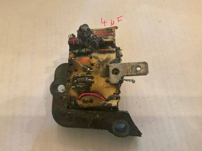

Next, the PCB as fitted. You can see the kill terminal, and HT lead connection, with PCB slot:
Finally, some of the components on the other side. Two disappeared, so I’ve marked them in. There’s a TO-92 package marked T, transistor/SCR? And possibly another one above it. I stopped there as I was only doing more damage and making a mess.
Could it be, looking at those diodes, that the charge/trigger events are defined by the direction of flux through the core? At a guess, I’d say the unit is charged as the magnet passes the upper leg, then spark is triggered by the magnet passing the lower leg.
