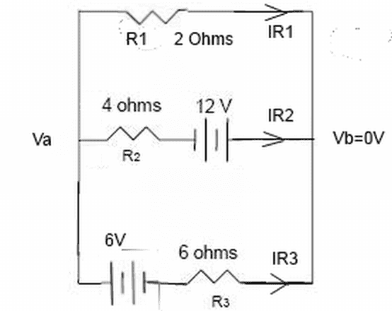

A. Make a prediction about the direction of current flow through each resistor. (6 points)
B. What current flows through each resistor? (15 points)
C. What is the voltage drop across R2? (4 points)
Req=R1+R2+R3
I'm sort of lost as to how to go about the equation. Normally I could tell the direction of the current when given a positive or negative sign near the battery.

Can you mark up the diagram with your initial assumptions about the voltage drops and currents.
I would start by marking the top left node Va and the bottom right node Vb=0V (arbitrary choice). Then apply KCL to one of these nodes.
I2=I1+I3
I prefer to write that in the form..
I1 +I3 -I2 = 0
Hint: You can write equations for each current in terms of Va.

I labeled top right resistor R1, the middle battery E1, middle resistor R2, bottom left battery E2, and bottom resistor R3. I didn't include Va or Vb anywhere because I never understood that stuff
I've redrawn the circuit and labeled up the currents. I made the arbitrary decision that they all flow into node Vb which clearly can't be true...
Applying KCL to node Vb you get
IR3 + IR2 + IR1 = 0 ... (eqn 1)
What we would like are equations for each of those currents. One way to do that is as follows...
Looking at the bottom row of the drawing you have the path...
Node Va --- 6V bat --- R3 ---- Node Vb
Using Ohms law we can write an equation for IR3 as follows..
IR3 = (Va - 6V - Vb)/R3
Since we have choosen Vb = 0 that reduces to
IR3 = (Va - 6V)/R3 ........ (eqn 2)
Using the same approach you can write..
IR2 = (Va - -12V)/R2 = (Va+12)/R2 .... (eqn 3)
and
IR1 = Va/R1 .......... (eqn 4)
Now put eqn 2,3,4 into 1...
(Va - 6V)/R3 + (Va+12)/R2 + Va/R1 = 0
Substituting values for the resistors that reduces to
Va = -24/11 Volts
Then each current can be calculated individually...
IR1 = Va/R1 = -1.091 A
IR2 = (Va - -12)/R2 = 2.455 A
IR3 = (Va - 6)/R3 = -1.364
As a check add up the currents...
-1.091 + 2.455 -1.364 = 0
Note that...
IR1 is negative so the current in the top is flowing in the oposite direction to my arrow (eg anti clockwise!)
IR3 is also negative so the current in the bottom loop is flowing in the oposite direction to my arrow (eg clockwise!).
Perhaps revise the prediction, draw the arrows the other way where necessary and repeat the calculations :-)

Thank you so much! That actually made sense in the end. Now about the third question, its about the voltage drop across R2. I used the V=IR equation substituting R2 with 4 ohms and I2 with 2.455 A and found that it was 9.82 V. Does that sound right?
It might be :-)
There is an easy way to check the drop on R2 because I calculated Va and Vb. The voltage drops down that branch must add to Va-Vb.
