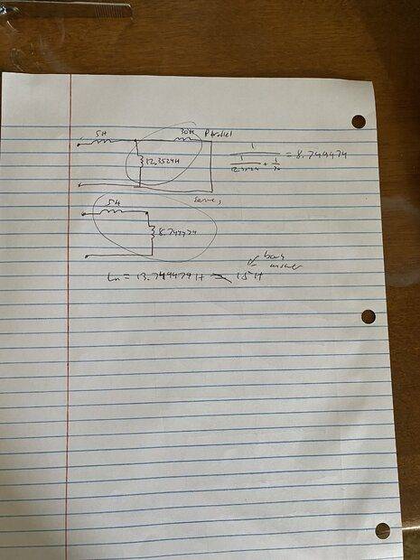

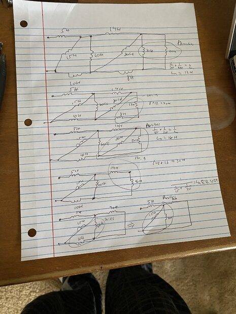

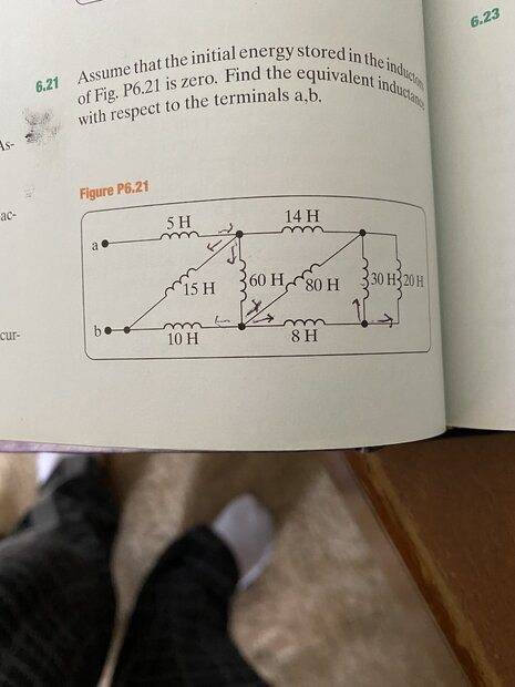

Assume that the initial energy stored in the inductors of Fig. P6.21 is zero. Find the equivalent inductance with respect to the terminals a, b.
L(series)= L1 + L2 + ... + Ln
1/(L(parallel)) = 1/L1 + 1/L2 + ... + 1/Ln
I am not sure where I made the mistake. If someone could point that out that would be much appreciated!
That next-to-last step on the first page looks wrong. You are combining two resisters as though they are in series and forgetting the one in parallel on the far top-right. Instead, that step should be to combine the far top-right with the parallel one second from the right.

Thanks a million! I got the correct answer.

20 // 30 = 12
+ 8 = 20
// 80 = 16
+14 = 30
// 60 = 20
+10 = 30
// 15 = 10
+ 5 = 15 H
