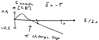

Cooling at high intensities
Let us consider an example, of laser cooling at high laser intensities. Keep in mind that laser cooling works because F=−αv and α>0. Assume we have a detuning of about one linewith, δ=−Γ. Now plot the friction coefficient α as a function of intensity:
Initially, at small intensities, α increases as a function of intensity. Don't be confused by the fact that the Doppler limit is achieved at low intensities. The diffusion coefficient is also linear in intensity at low intensity. α increases with I/I0 at first, and peaks around 0.5, but above the saturation limit α actually changes sign and starts heating. When α<0 then, counter-intuitively, blue detuned light can be used to cool atoms.
I'm not sure if your question specified one-dimentional or three-dimentional optical molasses but it covers both.
