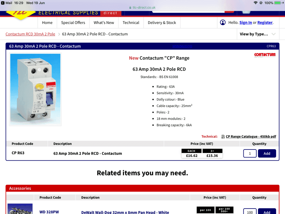

@essenmein this is what I mean:
Fits right on the DIN rail with the other breakers. Two of these would serve the whole house, each taking half of the circuits. Cheap, really. And no need to fit special outlets.
hah I know what they look like, and 16 pound seems like a bargain! compare:
245400
The chances of anything getting installed in the USA that would kill half the power in the house from an imbalance in currents caused by some device plugged in someplace is next to nil. Inconvenience caused by nuisance trips leads to defeating the safety feature of the device that trips.
