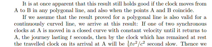

Hi.
Im looking into special relativity and everything i found about time dilation on internet seems to say that moving clock appear to tick slower than the stationary one. However what I found about this is following, in § 4. (Physical Meaning of the Equations Obtained in Respect to Moving Rigid Bodies and Moving Clocks) of Einstein's On the electrodynamics of moving bodies (1905):
Now if A is on a train (K') and B is a point on the track with synchronized clock (K), then according to this, the passenger A passing B would see B being ahead of his clock.
Please note it is not necessary for the train to stop for this to occur.
Also there can be any (infinite) number of such points, and they can be at arbitrarily short distances.
Meaning any point in the travel the stationary clock outside would be more and more ahead -> the other clock actually ticks faster, not slower.
So what am I missing?
Edit: from the point of stationary observer, the clock on the train would still be slower.

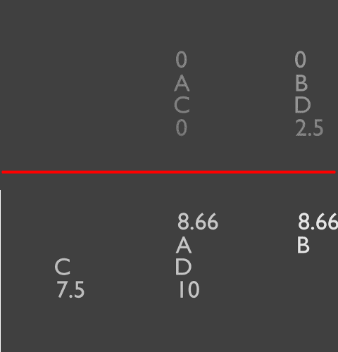

There is no contradiction if you allow for relativity of simultaneity. However, you first have to be clear about exactly what it means to say that one clock is “running slower” than another:
Say that you and I are moving relative to one another at speed .8c. As we pass one another (so that we are momentarily at the same place at the same time) we both zero our clocks. One minute later I look at my clock and see that it reads 1:00, and of course you are .8 light minutes away from me. 48 seconds after that (because that’s how long it takes light from your clock to cover the .8 light-minute distance between us) I can see what your clock read at the same time that my clock read 1:00; this turns out gone 0:36 so I correctly conclude that your clock is running slow by a factor of 3\5. That’s what “running slow” means - at the same time that my clock reads something, your once-synchronized clock reads something less. It critically depends on the meaning of “at the same time”.
But relativity of simultaneity means that we do not agree about “the same time”. Usingthe frame in which I am at rest the event “your clock reads 0:36” happens at the same time as the event “my clock reads 1:00”. But it does not follow that these two events are simultaneous in the frame in which you are at rest. Instead, using that frame, the event “your clock reads 0:36” happens at the same time as the event “my clock reads 0:21.6” (that’s 3/5 of 36) and the event “your clock reads 1:00” happens at the same time as the event “my clock reads 0:36” and you correctly and without contradiction conclude that my clock is the slow one.

There is no contradiction as long as you include the relativity of simultaneity. The way to include all of the relativistic effects (time dilation, length contraction, and relativity of simultaneity) is to use the Lorentz transforms. Using units where c=1 and neglecting y and z we have the forward and inverse transforms:
##t'=\gamma(t-vx)##
##x'=\gamma(-vt+x)##
##t=\gamma(t'+vx')##
##x=\gamma(vt'+x')##
where ##\gamma = (1-v^2)^{-1/2} > 1## and ##0<v<c=1##. (Note, this is the Lorentz transform, not the Doppler effect)
Now, for a clock at rest at the origin of the unprimed frame ##x=0##. So in the primed frame ##t'=\gamma (t-vx) = \gamma t##. Because ##\gamma>1## this implies that the unprimed clock runs slow in the primed frame.
Similarly, for a clock at rest at the origin of the primed frame ##x'=0##. So in the unprimed frame ##t=\gamma t'##. Again, the primed clock runs slow in the unprimed frame.
What you are looking at as a contradiction is a completely different thing. Going back to considering time in the primed frame, instead of looking at the line ##x=0## (representing a single unprimed clock) you are looking at the line ##x'=0## (representing a multitude of unprimed clocks as they pass by a single primed clock). In other words, instead of considering the rate of a single unprimed clock over time, you are considering the time displayed at a single instant for multiple unprimed clocks. To calculate this we first have to solve ##x'=0=\gamma(-vt+x)## to get ##x=vt##. Substituting that in we get
##t'=\gamma(t-vx)=\gamma(t-v^2 t)=\gamma (1-v^2) t = t/\gamma##
Therefore, looking along the line ##x'=0## at the unprimed clocks we see the effect that you are noticing. However, again, this is not the rate of a unprimed clock in the primed frame.

This is the next passage:
Now it would appear this effect will persist even if you do not use different clocks each time as you can place A = B and follow any polygon or continuously curved line
That is not time dilation either, but a related effect called differential aging.

Wow, that might be it. I was suspecting this will be completely different phenomena since the effect seems to be limited to 50% of stationary time.
That’s not quite true either. You can leave a place and return having traveled at speeds arbitrarily close to the speed of light and find that arbitrarily large amounts of time have passed for the stationary observer relative to your own time.
