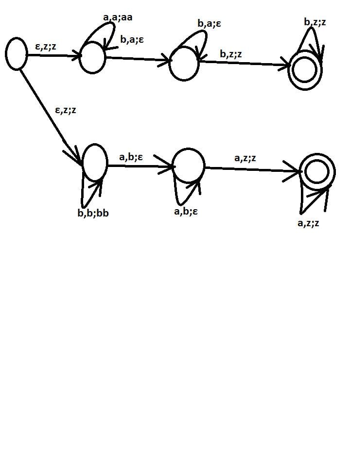

I wanted to draw a pushdown automaton,but I haven't found a lot of examples and I haven't really understood,how such automata can be drawn.
Could you explain me? :eek:

Here's one for a pushdown automaton that accepts $0^n1^n$.
We start in state $\color{brown}p$ where symbol $\color{green}0$ is accepted.
On the stack we track the number of $\color{green}0$s that we accepted as the number of $\color{blue}A$s.
When a symbol $\color{green}0$ comes in while the stack still contains the initial stack symbol $\color{blue}Z$, $\color{blue}A$ is pushed onto the stack ($\color{blue}Z$ is replaced by $\color{blue}{AZ}$).
When another symbol $\color{green}0$ comes in while the top of the stack contains $\color{blue}A$, another $\color{blue}A$ is pushed onto the stack ($\color{blue}A$ is replaced by $\color{blue}{AA}$).
And so on...Aha! You have a mathy avatar now. Good! :D

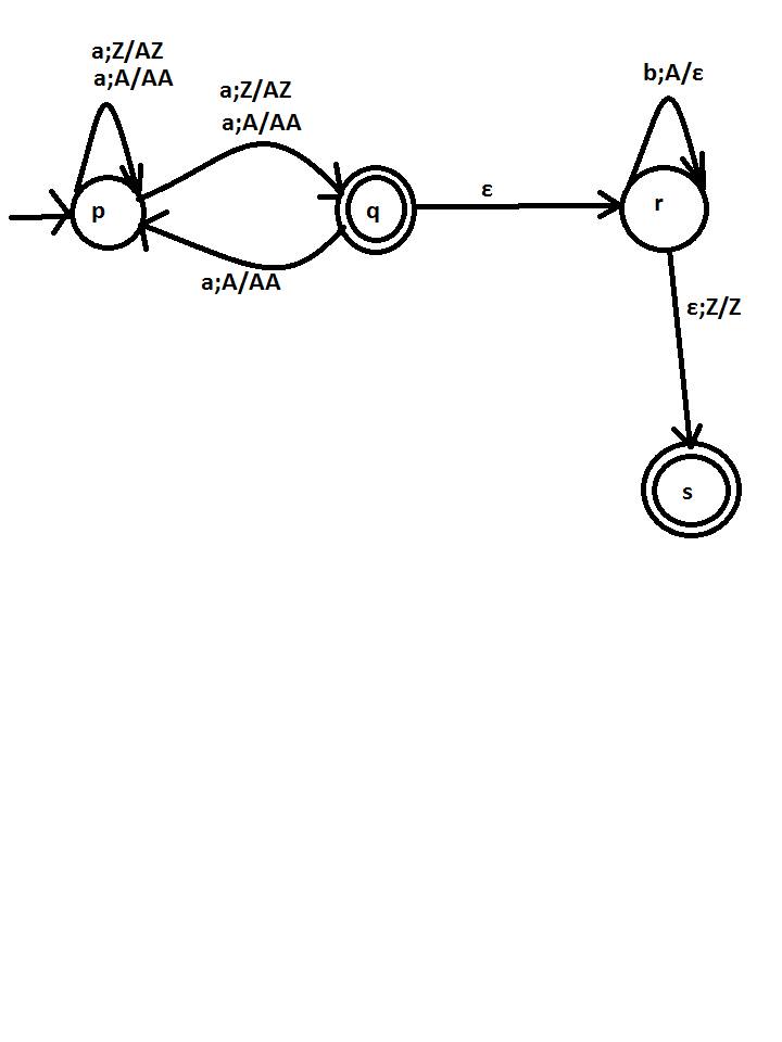

And so on...
I have tried this,but I don't think that it is right..I haven't really understood the stacks :confused:
The problem here is that for instance $ab$ is accepted.
If we take the upper branch in your automaton and accept $a$ once, we can then make a shift to the next state while accepting $b$, and then let the automaton finish.
We need a stack to keep track how many $a$'s were accepted.
So in each transition, we do not only accept an input symbol, we also manipulate the stack.
Going back to the example I just gave (from wiki).
Here is how the stack would develop while reading the string $0011$.
Leftmost you see that the stack begins as
$$\begin{bmatrix}Z\end{bmatrix}$$
After reading the symbol $0$, an $A$ is pushed on top of it.
So we get the stack
$$\begin{bmatrix}A \\ Z \end{bmatrix}$$
After reading another symbol $0$, another $A$ is pushed on top, yielding
$$\begin{bmatrix}A \\ A \\ Z \end{bmatrix}$$
Note that there are as many $A$'s on the stack as we have read $0$'s.

I have tried again to draw the pushdown automaton.That's what I did:
Looking good! ;)
One problem (or rather 2): the strings $aa{}^*$ and $bb{}^*$ are not accepted while they should.

I like Serena said:
Looking good! ;)
And what could I change,so that the strings $aa{}^*$ and $bb{}^*$ get accepted? :confused:
Well, you could for instance replace the first transition $a;Z/AZ$ by $\varepsilon;Z/Z$ and also the first transition $b;Z/BZ$ by $\varepsilon;Z/Z$.

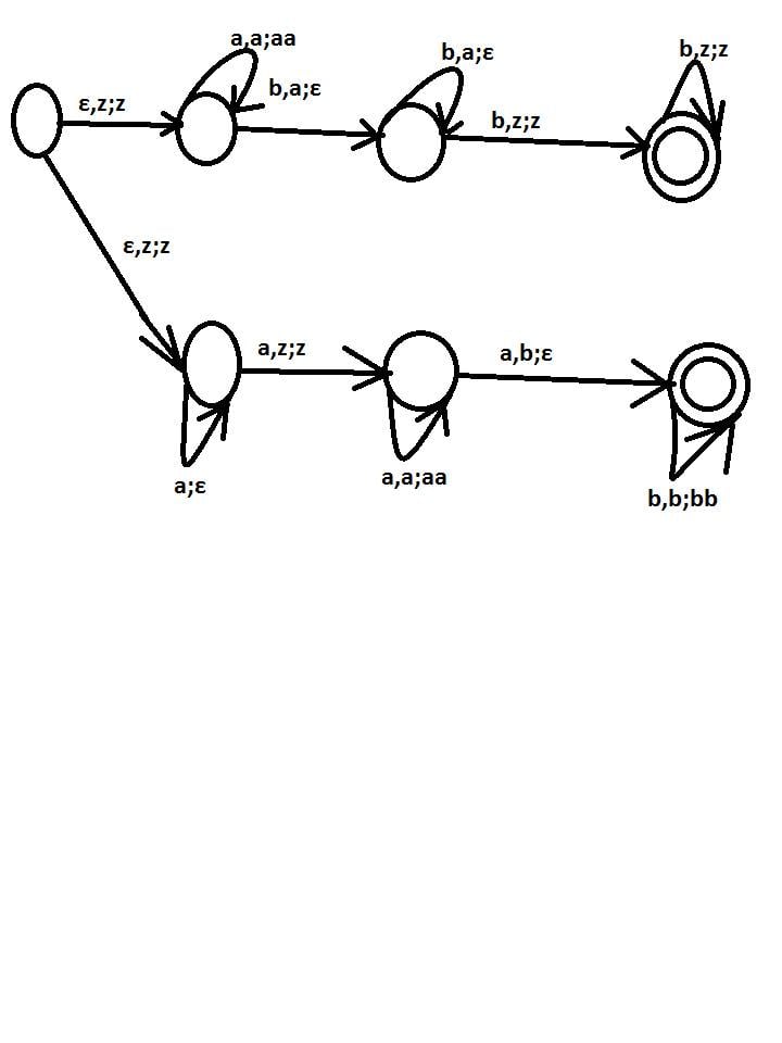

So,should it be like that?
Yep. All good now. (Priidu)

Oh wait! :eek:
The PDA correctly accepts $a^nb^nb^+$ in the upper branch.
However, in the lower branch it accepts $b^na^na^+$... that is not right. :eek:
It should accept $a^+a^nb^n$.

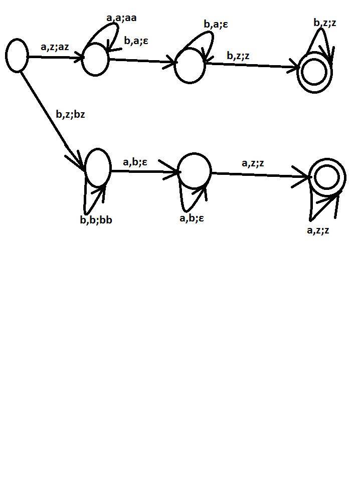

I have changed it :) Is it right now?
  • #32
Let me take a more careful look this time. :eek:
In the upper branch we can read $\varepsilon$ and leave the stack as $z$.
Then, in the next state, we can read $a$, but only if there is an $a$ on the top of the stack... but the first time there is a $z$ on top, so we're stuck! :eek:
In the lower branch we can now read $a^+$, leaving a $z$ on top of the stack, which is good.
Then we're stuck again, because we can't move on as long as the $z$ is still on top of the stack.
When we're able to pass that blockage, there is one more hurdle.
We will have a stack full of $a$'s... and we can only move on if there is a $b$ on top of the stack, but they were never pushed onto the stack! :eek:
