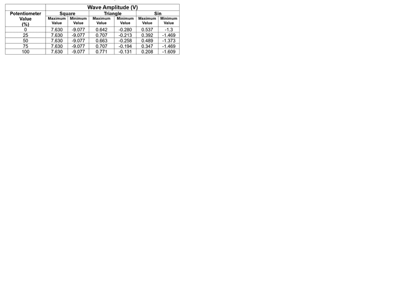

TL;DR Summary: Hi, i'm trying to talk about the results, this is a research assignment so i have no support
Hello, so here is the circuit. Its a basic signal generator, My issue is in the practical version, the potentiometer effected frequency, but in the simulation this is not the case... I also don't understand why the output voltage for each percentage is going up and down. I assumed since voltage is constant, as the resistance is increased the output should decrease. I can't find any recources either because i don't know what i'm looking for. The table of my results are here too, any help is appreciated.

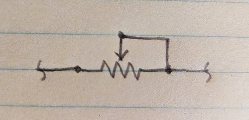

Check the simulation terminals you have used on R3. It seems you have a fixed resistance.
If that works in the simulation, but not in a practical circuit, then you have made a wrong connection somewhere. How have you built the circuit?
Umm... What?
As the resistance is increased the frequency out of the first stage should decrease, but it's voltage should stay the same. The next stage is a low pass filter, so higher frequencies are attenuated compared to lower frequencies.
@DaveE pointed out your connection flaw, missing the connecting of the tap to one end.

so the oscilloscope reading... if you leave it running the sin wave translates down and doesn't stop, while the triangle translates up and doesn't stop. Square stays the same... i really don't understand and nothing is making sense to me especially since the simulation frequency is not changing with the potentiometer

That is because you have connected to the wrong terminals of the R3 potentiometer.
Do NOT connect to the two ends, because that is a fixed 100k resistance.
Connect to one end, and to the variable wiper terminal.

I see... i was told to connect it that way, so i was hesitant to change it
An alternative is to wire it as a fixed resistor and change it's value in the simulation with commands like .param & .step (or equivalent).
