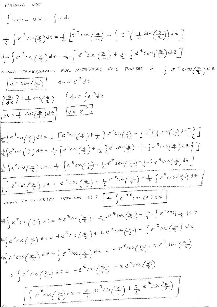

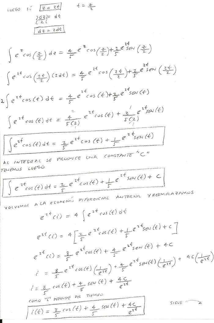

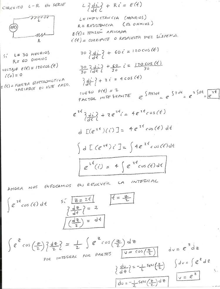

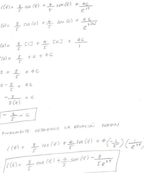

hello ... I'll put some solution, as I do not drive the latex language, then I take pictures of the leaves with my solutions ... the user who wants to give more solutions is well received and is welcome ...
https://www.physicsforums.com/attachments/1069View attachment 1070View attachment 1071View attachment 1072

hello ... MarkFL wanted to ask in this exercise that I not included the other sheet where I resolved scanned electric charge point at time t, if I scan this one could include in the photos that I gave to principle for the exercise remains continuous all the consecutive sheets, or conversely if I scanned would remain as a separate attachment to what I already I solved the circuit.att
