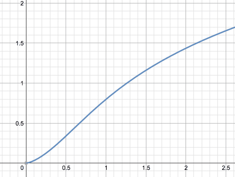

Since this is the main model equation (practically the only one, the rest can be readily be derived from it)
$$u(x) = \sinh^{2/3}(\frac{3}{2}x)$$
I'll post a plot of it. This shows how the size of a generic distance increases with time. Recall the present is about 0.8.
You can see a switch from convex to concave around 0.45 which is where distance growth gradually stops decelerating and begins to accelerate.
The plot is by an easy to use free online resource called Desmos.

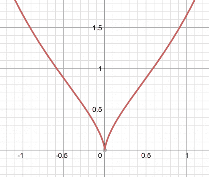

I think the way to understand "dark energy" also known as cosmological curvature constant Lambda is to look at its effect on the growth history of the universe. It could just be a small inherent constant spacetime curvature built into the geometry---a tendency for distances to expand, over and above other influences---or it could arise from some type of energy density we don't know about. But the main thing is to look at its effect.
That's why I plotted the expansion history of a generic distance a couple of posts back. In case any newcomers are reading, this distance was one unit right around year 10 billion (that is about x=0.6 on our scale). And you can look and see that at present (x=0.8) it is around 1.3 units. You can look back and see what it was at earlier times like x=0.1. Distance growth is proportional, so the unit here could be any large distance, a billion lightyears, a billion parsecs, whatever. People on another planet who measure distance in some other unit could discover the same formula and plot the same curve. This is the history of any large-scale cosmic distance. I mean the righthand (expansion) side of the graph is.
So back at time x = 0.1 the distance was 0.3 units, at time x=0.3 it was 0.6 units, at time 0.6 it was 1 unit.
The really interesting thing, I think, about this plot of our universe's expansion history is that around time x=0.45 you can see it change from convex to concave that is from decelerating to accelerating.

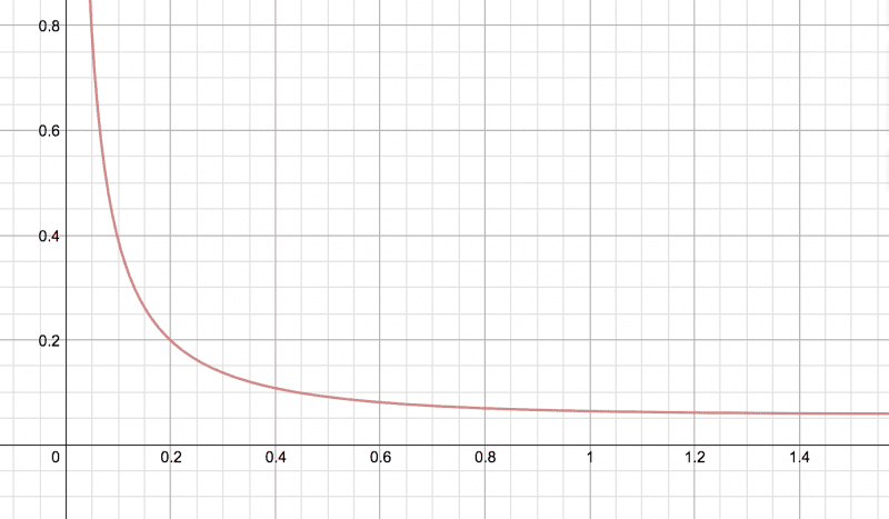

That has to do with the growth rate, which is flattening out.
Here the x-axis is time (in units of 17.3 billion years, as before).
The y-axis shows the growth RATE in fractional amounts per billion years. It levels out at 0.06 per billion years, which is (1 per 17.3 billion) the long term rate determined by the cosmological constant.
Around x=0.45 the percentage growth rate reaches a critical amount of flatness so that practically speaking it is almost constant. And you know that growth at a constant percentage rate is exponential. A savings account at the bank grows by increasing dollar amounts because the principal grows, and it would do so even if the bank were gradually reducing the percent interest rate, as long as it didn't cut the rate too fast.
So growth decelerates as long as the percentage rate is declining too steeply, and then starts to accelerate around x=0.45 when the decline levels off enough.
It happens because that is when the MATTER DENSITY thins out enough. A high density of matter, by its gravity, slows expansion down. The matter thinning out eventually exposes the inherent constant rate that provides a kind of floor. I hope this makes sense. I am trying to relate the growth RATE history plot here to the resulting growth history plot in the previous post).
