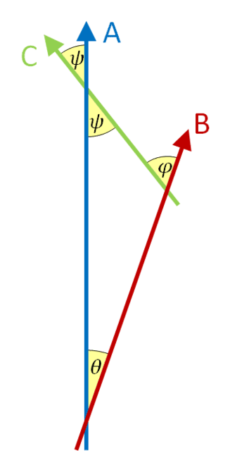

pervect said:
My favorite approach to spatial curvature is the sphere - rather than talk about parallel transport at a high school level, I'd talk about the sum of the angles of a triangle being greater than 180 degrees to attempt to explain the idea of curvature. Unfortunately, this approach won't work for space-time curvature, because the sum of the angles approach just doesn't generalize :(. The idea of drawing a space-time diagram on a curved surface, such as a sphere, rather than a flat plane is a valid approach, but the sum-of-angles idea doesn't survive the translation from Euclidean geometry to Lorentzian geometry.
I think this can be translated to Lorentzian geometry, but only in the special case where all three sides of the triangle are timelike.
First of all we have to remove the dependence on 180°, and express the Euclidean result in the form that one exterior angle is equal to the sum of the opposite interior angles, i.e. in the diagram below, ##\varphi = \theta + \psi ##.
Now, reinterpret the diagram as a spacetime diagram where ##\theta ##, ##\varphi ## and ##\psi ## are rapidities instead of angles. This now represents a variation of the twins paradox, let's call it a triplets paradox, where triplets Alice, Bob and Carol are initially together moving inertially, Alice then starts to move inertially with rapidity ##\theta ## relative to Bob and Carol. Some time later, Carol then starts to move inertially with rapidity ##\varphi ## (greater than ##\theta ##) relative to Bob in a direction directly towards Alice. When Carol catches up with Alice, what will be the rapidity ##\psi ## of Carol relative to Alice? In flat spacetime the answer will be ##\psi = \varphi - \theta ##, but in curved spacetime it won't.
This can be translated into relative velocities ##u = \tanh \theta ##, ##v = \tanh \varphi ## and ##w = \tanh \psi ## (under the convention ##c = 1##), and so the standard velocity composition formula
w = \frac{v - u}{1 - vu}
will hold in flat spacetime, and generally won't hold around a triangle of timelike geodesics in curved spacetime. The discrepancy will depend on the size of the triangle.
"Relative velocity" in this case means as measured in the locally inertial frame in which one of the two participants is at rest. Alternatively you can define in invariant way by the formula
U_\alpha V^\alpha = \frac{1}{\sqrt{1 - v^2}} \quad (=\cosh \varphi)
to define the relative velocity ##v ## between two 4-velocities ##\textbf{U} ## and ##\textbf{V} ##.

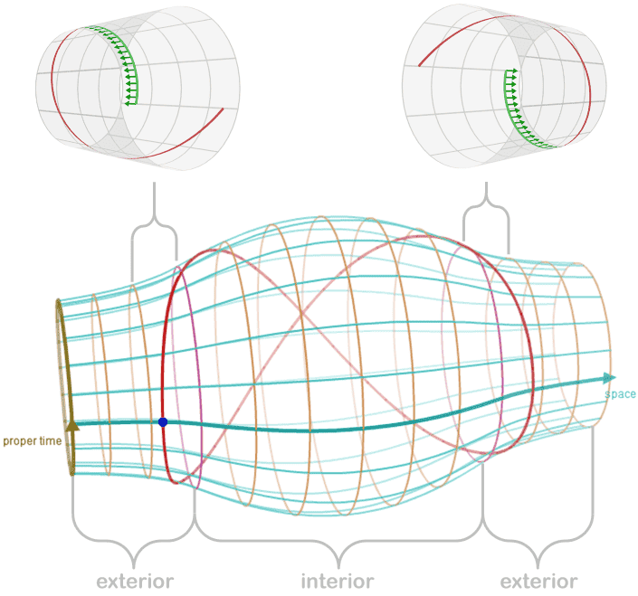

PeterDonis said:
You will not have that on a cylinder
The article I linked to in post #17 talks about the cylinder case towards the end. However, I'm still not sure that initially parallel geodesics on a cylinder will intersect. (I still haven't worked out the details for initially parallel geodesics even on a cone.) What the article I linked to makes clear is that, on either a cone or a cylinder, even though they are flat geometrically, you can have multiple geodesics between the same pair of points. That's not quite the same thing as initially parallel geodesics intersecting.

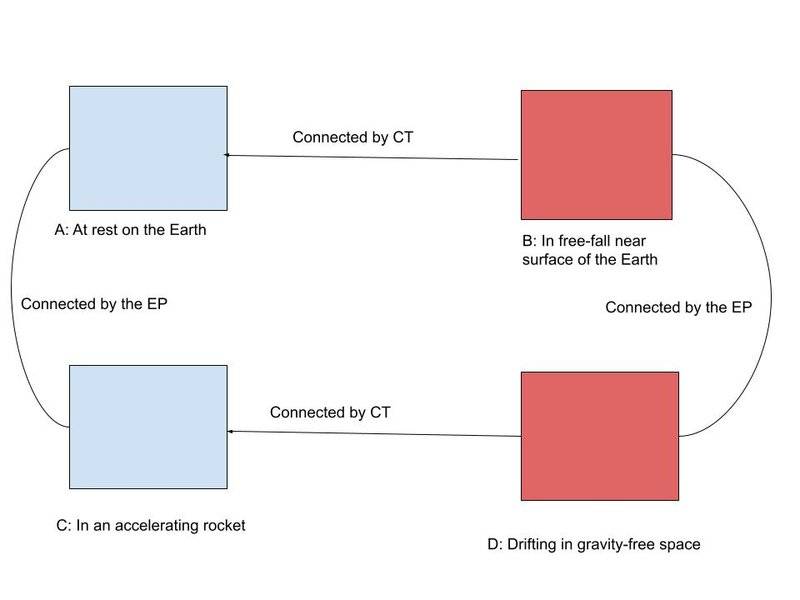

It seems like a simple deduction:
  1. If light does not bend, as observed inside an elevator floating in gravity-free space, then it does not bend, as observed inside an elevator in freefall near the Earth.
  2. If light does not bend as observed in an elevator in freefall near the Earth, then it DOES bend as observed by someone at rest on the surface of the Earth.
Point 1 follows from the equivalence principle. Point 2 is just algebra. If it takes ##\delta t## seconds for light to travel from one side of the elevator to the other, then since the elevator is falling, the elevator will have fallen a small distance during that time. For the light to hit the same distance above the floor, then the light path has to bend down.
  • #31
I'm not saying the argument you make is wrong. I'm just saying that this part...
...is not an argument based on the equivalence principle, since your argument involves "someone at rest on the surface of the Earth" who is not inside the elevator and who is not within the small patch of spacetime in which the EP can be used.
What the EP tells you is that measurements restricted to inside an elevator in free fall can't tell you anything about the bending of light, since such measurements detect no bending of light; but measurements restricted to inside an accelerated elevator can.
  • #32
No, it's physics, but physics not restricted to the small patch of spacetime within the elevator that the EP is restricted to.
  • #33
This seems silly to me. If you like, you can let the person on the surface of the Earth be inside an elevator. That certainly doesn't make any difference. I'm NOT invoking the equivalence principle to compare the person at rest on the Earth to anybody in a rocket ship. I'm invoking the equivalence principle to compare the person in a freefalling elevator to a person in an elevator floating in space.
It's a two-part argument. The first part involves the equivalence principle. The second part only assumes the falling elevator approximately obeys Newtonian physics, that its height as a function of time is approximately given by ##h = h_0 - \frac{1}{2} g t^2##.
  • #35
Your comment seems very weird to me. You're saying that if it all takes place inside an elevator, that's a small enough patch. But if we make it large enough to include the elevator, plus someone standing beside the elevator as it falls, then that's too big to be a single patch?
