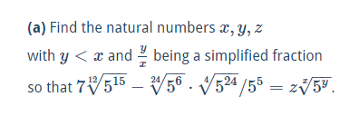

Hi All
I have this problem. My workings are attached.
My answer was:
x=4
y=5
z=6
This is wrong. I don't know where I'm going wrong.
I'd be really grateful if someone could help.
Thanks!
Daniel

No, it's correct! I can't make out your working so I'll post mine for comparison:
$$7\cdot\sqrt[12]{5^{15}}-\sqrt[24]{5^6}\cdot\sqrt[4]{5^{24}}/5^5$$
Rewrite in index notation:
$$=7\cdot5^{5/4}-5^{1/4}\cdot5^6/5^5$$
$$=7\cdot5^{5/4}-5^{1/4+6-5}$$
$$=7\cdot5^{5/4}-5^{5/4}$$
$$=6\cdot5^{5/4}$$
$$=6\sqrt[4]{5^5}$$
