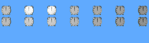

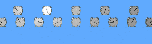

  • #108
Freixas said:
Well, it's nice to be right about something!
Before I asked my first question on PhysicsForums, I had worked through an interesting conundrum. We have a line of A objects equally spaced and in the same inertial frame. We have a similar line of B objects so that each A object is adjacent to a B object. B objects are all in the same inertial frame, but a different frame than A. It appears that A's and B's will all be in conjunction at regular intervals.
You mean something like this:
I was able to figure out on my own that this could only be the situation from one viewpoint. In the other frame, A's (or B's, depending on the viewpoint) would be closer together and conjunctions would not be simultaneous at all.
Such as when when you switch to the frame for the top row of clocks, and get this:
Likes Freixas

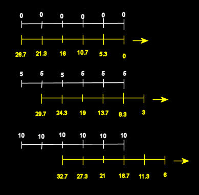

  • #109
  • #110
One point of terminology: instead of "in an inertial frame", it's much better to say "at rest in an inertial frame". All objects are "in" all inertial frames; they don't disappear from one particular frame just because they happen to be moving in that frame.

  • #113
I'm puzzled by this animation. The clocks are small and I can't single-step through it, but aren't the clocks in the top row running at the same rate as the ones in the bottom row? Shouldn't they be running slower?
  • #114
For this particular set of animations, I assume that the clocks in the upper row have had their tick rates adjusted so that they match that of the clocks in the lower row as measured from this frame. That way, as any clock in the top row passes a clock in the lower row, they read the same time.
Then when we switch to the frame in which the upper row is at rest, we see that, even though the clocks are all out of sync with each other, the lower clocks run slower than the upper clocks, and the lower clocks are closer together, whenever a lower and upper clock pass each other they still read the same time.
  • #115
Mister T said:
When you adjust for light travel time you are assuming that a clock located there (where the movie was made) is synchronized with a clock located here (where the movie is viewed).
Freixas said:
This is not my assumption at all; my problem statement long ago implies the opposite.
Anytime anyone adjusts for light travel time what they are doing is saying that when the light left some distant position over there, the time over here was such-and-such. For example, if the light arrives here at 9:00 am and was emitted from some position that's one light-hour away from here, I will conclude that the light must have left at 8:00 am. Let's say I just happened to be taking my first bite of breakfast at 8:00 am. I therefore conclude that the emission of the light was simultaneous with my first bite.

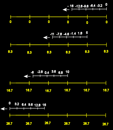

@PeterDonis: I like to work things out fully for myself, which takes time. I understand things better when I can crank through all the logic on my own.
I thought I had found an error in my work. This just told me my conclusions were wrong, but it didn't provide a solid understanding of why. Thus, I revisited the thread and re-read a number of your posts.
I realized I still didn't understand how BN could read A's clock as 1.8. Tracing through your comments, I think the problem starts here:
PeterDonis said:
No. Both B1 and BN are at rest relative to each other, so they have the same notion of simultaneity. So whatever B1 says A's clock reads at a given time, BN will say the same. That's what "clock synchronization" means.
If I take this approach, I arrive at a logical contradiction. So I clearly still don't understand.
Let's look at things from A's frame only. Let's remove the infinite line of closely spaced B's and replace it with a line of B's that are spaced evenly 4 LY apart as measured by A. Traveling at 0.8c, A will expect to see a B pass by every 5 years. The math seems simple and unavoidable. Each time a B passes by and sees A, it should see that A's time is a multiple of 5 (if the first conjunction occurred at 0). I can't picture any other scenario that makes sense. We're are looking at things from A's view, but the event (and A's clock reading) is in all frames.
I'm not looking at things from B's frame at all. It shouldn't matter. A's viewpoint provides all the information I need. We don't care about B's clock anywhere, just about what A's clock says at conjunctions.
You tell me that the first trailing B (what you call BN) will see A's clock as reading 1.8 years at conjunction. I can't see how. Help!
This is really the heart of my objection. What follows is just details.
Let me draw the clocks based on your statement about clock synchronization. I am going to add a line of A's, also spaced 4 LY apart as measured by A.
A . . . . A . . . . A . . . . A . . . . A
B . . . . B . . . . B . . . . B . . . . B
^-7.2 . .-5.4 . . .-3.6 . . .-1.8 . . . 0
^-5.4 . . .-3.6 . . .-1.8 . . . 0
^-1.8 . . . 0
^0
The caret points to the corresponding B's view of each of A's clocks at B's time 0. The time listed under each A, is the time as perceived by the B with the caret. As I imagine movement in typical Western left-to-right fashion, the rightmost A is the one that we've been concerned with. The rightmost B is the "lead B" or B1. All times are for when the lead B is at time 0, so all B's perceive the lead A to have time 0. This is my interpretation of your statement.
The other times are what I think they would be so that B would perceive A's clocks advancing by 1.8 years as one B went to the next. If we advance this diagram by 3 years (B's time) or 5 years (A's time), the trailing B would say that the lead A's clock reads 1.8, which I believe to be impossible.
Here's the way I think things should like so that B sees a multiple of 5 at each conjunction. B also sees A's clocks advancing by 1.8 years during the trip:
^0 . . . 3.2 . . . 7.4 . . . 9.6 . . . 12.8
^0 . . . 3.2
^0
In this example, the last B would reach A (the lead A) in 4 * 3 = 12 B years (4 * 1.8 = 7.2 years A years from B's view) and A's clock would read 7.2 + 12.8 = 20.
In my diagram, when B's clocks are at time 0, each adjacent A's clock also reads 0. But the lead A's clock reads 0 only for the lead B.
I have no idea if this diagram is a representation of how things work. All I can say is that it satisfies these two constraints: A's clocks are a multiple of 5 at conjunctions and B's perceive A's clock as running at 0.6x (assuming I did the math right, always a concern).
