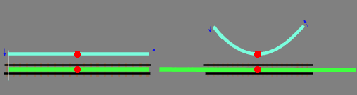

To build on Ibix's point, Let's consider the following two illustrations:
On the left we have our rotating pole (light blue bar), The tracks (black and brown lines), the train( green line) and our observers on the embankment and on the train (red circles), according to the embankment frame. This is the moment the observers pass each other. The pole is parallel to the tracks, and its ends line up with both the end of the train and particular points on the track (the white lines). The pole is rotating counter-clockwise as shown by the blue arrows.
One thing needs to be noted in this image, the train, since it is moving relative to this frame is length contracted. In other words, the length of the train as measured in this frame is shorter than the length of the train as measured in its own frame.
This becomes apparent when we look at the right image, which is drawn from the frame of the train. We are still dealing with the moment the two observers pass each other. In this frame the train measures its length as its proper length, while it measures the tracks and embankment, which is moving relative to it as being length contracted. As a result, the train no longer fits neatly between the white lines, but extends quite a bit beyond is both directions. This also means that one end ( the right end in this case) has already passed its white line before the other end hasn't reached its white line yet.
Also note that the bar appears as being curved, as per Ibex's post, and the right end of the pole has already gone past the point where it is adjacent to the tracks, while the left end has not yet reached that point. If this were an animation that we could run backwards and forwards, you would see the ends of the train lining up with a white line at the same moment that an end of the rod was adjacent to the same spot. This just happens at different times for each white line. Another thing to note here is that as the rod rotates in this frame, the curvature of the rod does not remain constant but changes from being curved as shown here to being straight when aligned vertically.
Likes Ibix

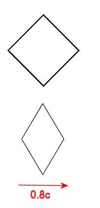

Just because the See-saw is curved in her frame does not mean that it is under stress in her frame.
In the following image we see the same diamond shape, in both its rest frame and according to a frame in which it is moving at 0.8c.
In the top image all the corner angles are 90 degrees, in the bottom image, one pair of corners is more than 90 degrees and the other pair is less than 90 degrees. But this does not mean that the shape is under some type of stress at the corner. Even if the shape was rotating, and thus constantly changing shape in the bottom frame, it would not be undergoing any stress.

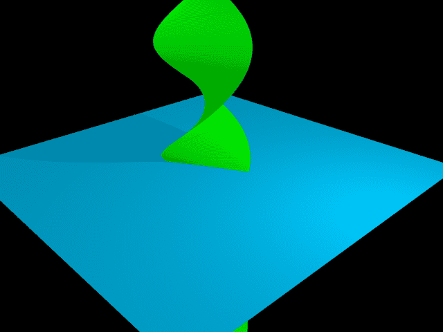

This might be another way to look at it.
In the rest frame of its centre of mass it's straight, and rotated at each subsequent time. So a rotating rod can be viewed as a helical worldsheet. This can be illustrated with a (2+1)d Minkowski diagram - I've drawn one below. One spatial plane of the rest frame is marked as a blue plane (time is perpendicular to this), and naturally the intersection of the green helical worldsheet and the plane is a straight line. So the rod is straight in this frame.
But what happens in a moving frame? In a moving frame, the spatial plane is tilted compared to the one drawn above. That looks like this:
Now you can clearly see that the intersection of the helix and the plane is a curve. That's why the rod is curved in this frame (although as @pervect notes, there's a special case when the rod is "across" the slope where it'll be straight). You can also see immediately that I've changed nothing about the rod by changing the frame. So it can't be broken; it's just the intuitive notion that "if it isn't straight it ought to be broken" that doesn't work properly.
Likes PeterDonis
