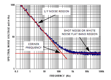

Take a short time-out and read about noise in audio amplifiers. Read the data sheets for your instruments, amplifiers, devices, etc.
It probably looks something like this:

I have read it previously already. The above is at 5nV/Sqrt(Hz). This means if the bandwidth is 20kHz. the noise rms is 5n/Sqrt(Hz) x Sqrt (20Khz BW) = 5 x 141.42 = 707nV rms or 0.707 uV rms noise at 20kHz bandwidth. My question is supposed the function generator would produce a 1mV signal at 5kHz and 15 Khz. Would they have similiar noise amplitude at 5kHz and 15kHz given the noise is 0.707uV rms at 20kHz?

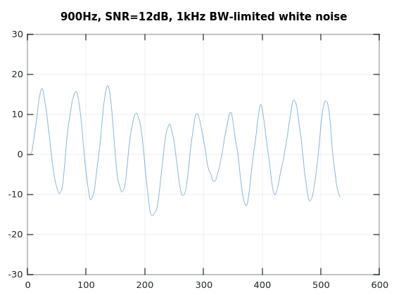

Someone made a plot of the noises at 50Hz vs 900Hz using 1kHz bandwidth. Why do the noises not look the same? The 50Hz is rough, the 900Hz is smooth.
Please stop referring to noise at spot frequencies. In both cases, the noise fills the available 1 kHz bandwidth. It is the signals being plotted, that are at 50 Hz and 900 Hz.
Because the horizontal axis is different, by a factor of 16.67 between the plots. Each shows about 10 cycles of the signal.

Do you know what signal processing techniques where they remove the jagged edges at the say 50Hz signal that is there at the original? Because in the BCI2000 software at a center. The output at 50Hz doesn't have any jagged edges noises.
For a sinewave, lower frequency noise causes the baseline to wander up and down. Higher frequency noise looks like small jagged pulses added to the sinewave.
Both plots have 1 kHz BW limiting.
The 900 Hz shows a very short block of time that stretches the noise horizontally, and so makes it look smooth. There is little noise between 900 Hz and 1 kHz, so most of the noise is lower frequency, that appears to make the baseline for 900 Hz wander more than that for the 50 Hz.
The 50 Hz has lots of time on the display, and plenty of higher frequency noise between 50 Hz and 1 kHz. That higher frequency noise looks jagged. The baseline of the 50 Hz does not wander as much as the 900 Hz because there is not much noise below the 50 Hz signal.

The noise is a separate broadband signal, present in the same channel as the sine wave signal. That noise will be amplified and attenuated with the sinewave, as it is processed. The sine wave is a narrowband signal, that can be detected or separated, from the broadband noise.
Distortion of sine waves, during generation or later signal processing, results in integer harmonics of the sine wave being present. If the distortion is symmetrical it will have odd harmonics only, if asymmetric, even harmonics will also be present. Each harmonic is another pure sine wave, at a higher frequency than the fundamental. The harmonic energy, resulting from distortion, may fall outside the band limited channel that carries the fundamental signal.
The noise, accompanying the sine wave, will depend on the bandwidth of the channel. The appearance of the noise, in the time domain, will depend on the position of the fundamental sine wave within the bandwidth of the channel. Noise at lower frequencies than the sinewave will appear as a wandering of the sine wave baseline, while noise at higher frequencies than the sine wave, will appear as jagged detail on the sine wave. That explains the problem with the title of this thread.
