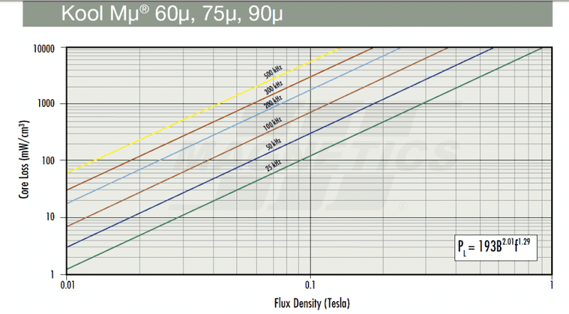

i saw several curves like this in the powder core catalog
C varies widely from around 40 to 500 but b's cluster around 2±15% and f's around 1.6±10%
now that's for powder cores

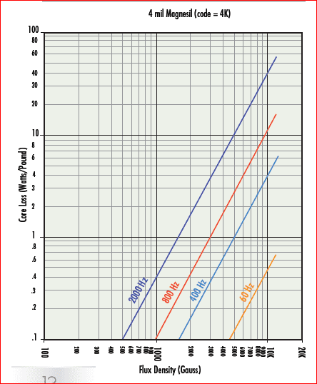

i didnt find stamped steel cores
their tape wound cores catalog has curves for several alloys but they didnt tabulate the curve fit constants for us
http://www.mag-inc.com/File%20Library/Product%20Literature/Strip%20Wound%20Core%20Literature/2016-Magnetics-Tape-Wound-Cores-Catalog.pdf
hope it helps you search further
