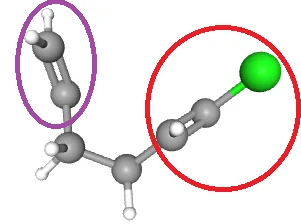

Another example:
First, a side question: in
https://chem.libretexts.org/Bookshelves/Organic_Chemistry/Organic_Chemistry_(Morsch_et_al.)/07:_Alkenes-_Structure_and_Reactivity/7.04:_Naming_Alkenes
it is stated
"Start numbering from the end of the parent chain which gives the lowest possible number to the double bond".
But what if there are two double bonds, and starting at one gives the same numbering as starting with the other? For example,
for (1E)-1-chloro-1,5-hexadiene? Here it seems that we are starting from the red, not the purple?
Now returning to the Z/E question, if we are talking about the red part, then the two bonds appear perpendicular -- so this would be neither Z nor E, but it was decided that it is E. Are the angles simply poorly represented in the diagrams?

Can you assign priorities of substituents of the "left" and "right" side of the double bond? Which has a higher priority - L1, or L2? What about R1 and R2? Z means either L1, R1 or L2, R2 are of higher priorities in each respective pair. Is that so?
Thank you very much, Borek. Your drawings are very helpful, and a bit of the fog is starting to lift. Let me see if I have this straight. The idea is to look at the two carbon atoms on each side of a double bond, one regards the group with the highest priority on one side, and then the group with the highest priority on the other side, and one compares them to differentiate Z or E. So far, so good; so I was comparing the wrong things. Super! I will work on this some more and be back if I still have difficulties, but this was a big boost.
