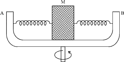

Sliding sleeve on a rotating bar with two springs
In summary, the problem involves a sleeve of mass m fixed between two identical springs with stiffness k, able to slide without friction over a horizontal bar. When the arrangement rotates at a constant angular velocity w, the period of small oscillations of the sleeve can be found using the equation T=2âˆ/(k/m-ω2)1/2. There is no simple solution without using polar coordinates.

P45) In the arrangement shown in figure, the sleeve M of mass m is fixed between two identical springs whose combined stiffness is equal to k. The sleeve can slide without friction over a horizontal bar AB. The arrangement rotates with a constant angular velocity w about a vertical axis passing through the middle of the bar. Find the period of small oscillations of the sleeve. At what values of w will there be no oscillations of the sleeve?
2. Homework Equations
T=2âˆ/(k/m-ω2)1/2
I got this answer by following the pseudo force approach but got stuck when I tried to do it with the normal method without pseudo force. Can we do it without using pseudo forces? And if yes then how?

Are you familiar with how to express acceleration in polar coordinates?
No. Its not in the curriculum I am doing.
