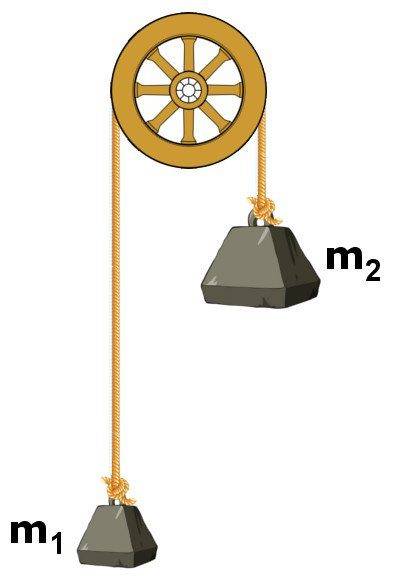

I have a physics practical test where I have to find the gravitational acceleration with the Atwood machine:
I've found 9.27 m/s² and have to say what could have caused this slight gap. They say that there is no friction in this experiment.
I can't really manage to find any (the time has by the way been measured with an ultra slow mo camera...).
If you could help me I would be very thankful!
Apart from the fact that frictionless doesn't exist in real life, what do you think might have been responsible? And how long was the rope? How was the acceleration measured?
I think investigating the effects of friction would be a good start. Can you post the relevant equations for friction in this experiment, and deduce whether including the forces of friction would give you a higher or lower value for the gravitational acceleration constant g? Can you think about any other forces that might have been present? How fast did the weights end up going?
You are looking for an error of 5.5%. If we are to help you will need to post full details of the set-up, the process, the data collected, and your calculation.
