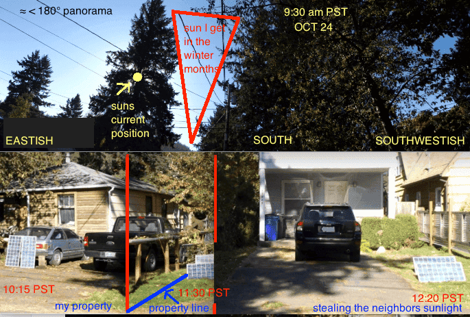

It would appear that my local situation has skewed my knowledge of solar power potential.
Having pretty much negligible solar available, I've not invested in current technologies.
I've always just hooked my solar panels directly to my battery.

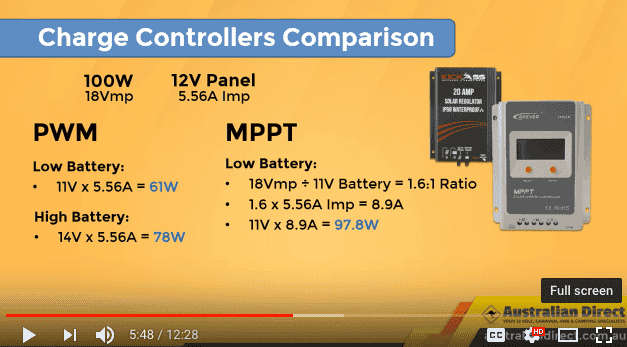

My experiment yesterday indicates that I might have been ignoring PWM & MPPT technologies:
My 95 watts worth of solar panels were only delivering 66 watts of power to charge my battery.
The following video indicates that I would be happiest with MPPT technology:
A snip from the middle looks like the PWM device is about the same as no device as all:
Googling indicates MPPT devices are not that expensive:
40A MPPT Solar Charge Controller [example I found]
$150​
Although that would increase* the cost of my system by $130, I think it would be worth it. (About the cost of a 100 watt solar panel)
ps. From the video; "Caveat emptor" as to what MPPT device you buy.

IMO you should investing a chain saw and reveal the Sun for a bigger part of the day. :smile:
It's always interesting to discuss a real implementation such as yours.
Your 66W from nominal 95W panel is no surprise to me. From what you can read, it appears that there is a significant amount of energy to be had when the volts from the PVs are not optimal so the MPPT regulator could be good value. My very cheap and cheerful regulator (based on a 40W panel) has a Boost Mode when the PV volts are low. It seems to spend most of its time in that mode but the actual charge current is pretty pathetic, of course. I have ruined one battery by draining it too much and too often. I think it will need several times the present capacity to avoid that problem. The actual nominal capacity that's needed to achieve a given usable capacity is one thing that could make it worth while going from Lead Acid to something more modern.
MPPT devices have very varied performance and I think you may be stuck with paying the high price of one from a 'specialist' Solar Energy firm, rather than a cheap one from China. There is a rich vain of opinions and experience on Sailing and Boating (and camping) Forums and I would recommend a bit of browsing in that direction.

Also, a spot of Glyphosphate could damage trees that are not on your property. Done surreptitiously, it could look like a weird disease and not sabotage.
Most are over 100 feet tall, so chain sawing and killing them are not options. (For me anyways. And they ALL belong to my neighbors.)
My last battery died (2014) because I ignored the fact that it sat an entire winter uncharged.
It's academic now as to which MPPT device I should have bought, as I have one on order now. It is scheduled to arrive on Monday. $120, 20 amps, 12 or 24 vdc, Deep cycle Sealed, Gel, Flooded and Lithium battery option ready.
