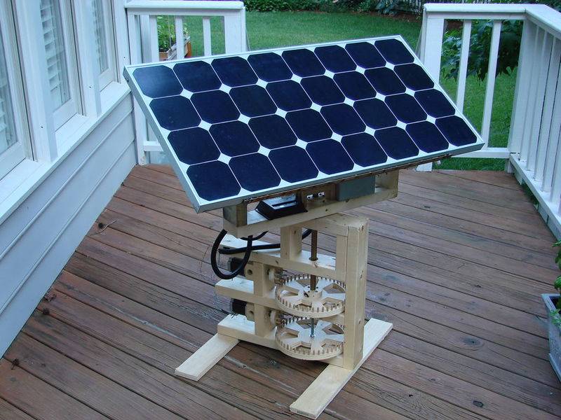

Hi everyone i am working on a solar tracking system for a.solar panel that i made wheighting about 30kg , i was wondering where to start looking for books where they may give examples of.such devices with mechanisms and control theory or if.by any chance you have knowledge on the subject and could give me.any advise, that would be awesome:)

Easiest way is to get data for sun's traverse at different times of year for your GPS location and preset motion control system to track .
Here is a home-built solar tracking system which achieves what you're looking for I think: http://www.instructables.com/id/Solar-Tracker-in-the-Internet-Cloud/
Alternatively, this is kind of a cool tracking system which uses 4 light detectors and a pointing system, so it constantly tries to point at the brightest point in the sky (the sun) rather than calculate where the sun will be: http://www.instructables.com/id/Arduino-Solar-Tracker/

Think of a four-sided pyramid. Place it on the solar panel so the edges of the pyramid are parallel to the rotation axiis of the positioner. i.e. the 'top' and 'bottom' sides would be parallel the the Elevation axis. Place a small photosensor on each pyramid face. When the 'top' and 'bottom' sensors have equal output, the Elevation is correct. The same for holds for the Azimuth sensing. As long as the pyramid maintains its orientation relative to the solar panel, it doesn't have to be physically on the solar panel, just attached to the same moving platform. The actual control circuitry can be either analog or digital, whichever is more convenient for you.
