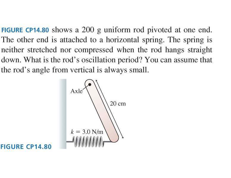

The figure shows a 200 g uniform rod pivoted at one end. The other end is attached to a horizontal spring. The spring is neither stretched nor compressed when the rod hangs straight down. What is the rod’s oscillation period? You can assume that the rod’s angle from vertical is always small.

Thinking about torques is a good idea.
When the rod has a small angular displacement θ from the vertical, what is the net torque acting on the rod (about the axle) expressed in terms of θ?

What does ##l## mean? Is this the rod's length, is it its half-length?
What about the torque from the spring?

You should express ##x## in terms of ##\theta##. Then, having the sum of torques equals, what can you do?

OK, so then the torque imposed by the spring = ##-kL\theta##?
And the torque from gravitational force = ##-Mg(L/2)\theta##?
Adding the torques together...
Net torque = ##(-kL\theta)## + ##(-Mg(L/2)\theta)## = ##-(kL+MgL/2)\theta##

You are on the right track. But: does ##kL\theta## have the dimension of torque? Compare this with the earlier earlier expression.

Oh I think I see what you're saying. ##kL\theta## has units of N, which isn't right for a torque. Since ##x = Lsin \theta ≈ L\theta##, does it follow that ##kL\theta## should be replaced by ##kL^{2}\theta##?
And if so, does the equation for ##\alpha## (above in post #7) change to the following?
##\alpha = \frac{-(kL^2+\frac{MgL}{2})\theta}{I}##

Yes, I think that's right.

##\alpha = \frac{-(kL^2+\frac{MgL}{2})}{I}\theta##, so ##\omega = \sqrt{\frac{(kL^2+\frac{MgL}{2})}{I}}##
meaning that the period = ##T = \frac{2\pi}{\omega} = 2\pi\sqrt{\frac{I}{(kL^2+\frac{MgL}{2})}}##
And since the moment of inertia for a solid thin rod pivoting about its edge is ##I = \frac{1}{3}ML^2##, the equation for the period becomes:
##T = 2\pi\sqrt{\frac{\frac{1}{3}ML^2}{(kL^2+\frac{MgL}{2})}} = 2\pi\sqrt{\frac{ML}{3(kL+\frac{Mg}{2})}}##
Is that right? Now I just need to plug in the numbers?

Looks good!
