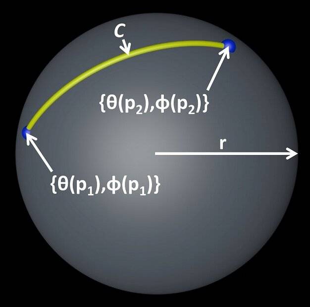

I am approaching what may be the simplest problem related to this equation. That is finding a solution for constant time and radius (t=constant, radius = constant).
I have written my results for this simplification below. I have two questions. One, am I doing the integrations correctly and two if the integrations are correct, how are the results combined and interpreted?
For time (t) = constant and r constant then the three dimensional space met-
ric becomes the metric of a two-dimensional sphere or radius r embedded in the
Euclidean space
d l^2 = r^2*(d(theta)^2+sin^2(theta)*d(phi)^2)
Taking square root of both sides :
dl = r*sqrt((d(theta)^2+sin^2(theta)*d(phi)^2))
Question : can this be solved by first setting theta =
constant, d(theta) = 0 and then setting phi = constant, d(phi) = 0 .d(theta) =
0? Result for d(theta) I think??
dl^2 = r*2*sqrt(sin*2(theta)*d(phi)^2) dl = r*sin(theta)*d(phi)

kirkr said:
This form suggests vector valued quantities (?)
No, arc length is a single, scalar quantity.
Consider your 2D example of the surface of a sphere of radius ##r## with line element ##ds^{2}=r^{2}\left(d\theta^{2}+\sin^{2}\theta\:d\phi^{2}\right)##. Draw any curve ##C## on the surface (see diagram), geodesic or otherwise. Since ##C## is 1D, positions along the curve can be written in terms of a single parameter ##p## that ranges in value from the start of the curve ##p_{1}## to its end ##p_{2}##. The 2D surface coordinates of the curve are then given by ##\theta_{C}=\theta(p),\;\phi_{C}=\phi(p)##. Hence, on the curve the line element becomes:$$ds^{2}=r^{2}\left(\left(\frac{d\theta(p)}{dp}\right)^{2}+\sin^{2}\theta(p)\left(\frac{d\phi(p)}{dp}\right)^{2}\right)dp^{2}$$Taking the square root and integrating over ##p## from ##p_{1}## to ##p_{2}## gives the (scalar) arc length ##L_{C}## of ##C##:$$L_{C}=\intop_{p_{1}}^{p_{2}}ds=r\intop_{p_{1}}^{p_{2}}\sqrt{\left(\frac{d\theta(p)}{dp}\right)^{2}+\sin^{2}\theta(p)\left(\frac{d\phi(p)}{dp}\right)^{2}}dp$$And if you can write a function relating the coordinates along the curve ##C##, such as ##\phi_{C}=f(\theta_{C})##, then the arc length simplifies to:$$L_{C}=r\intop_{\theta_{1}}^{\theta_{2}}\sqrt{1+\sin^{2}\theta\left(\frac{df(\theta)}{d\theta}\right)^{2}}d\theta$$From this 2D example you can readily generalize to the 4D Schwarzschild line element.

Taking up your response at the formula for scalar arc length,
You stated that if there is a function $$ \phi_{C}=f(\theta_{C}) $$
Then the line element can be expressed as:
$$L_{C}=r\intop_{\theta_{1}}^{\theta_{2}}\sqrt{1+\sin^{2}\theta\left(\frac{df(\theta)}{d\theta}\right)^{2}}d\theta $$
