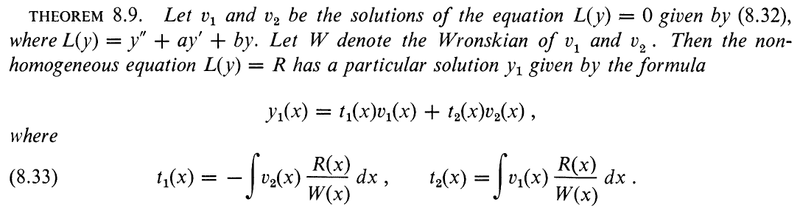

Thus, I have chosen to solve using a more general method based on the following theorem in Apostol's Calculus, Volume I
We have ##v_1(x)=1## and ##v_2(x)=x## as our solutions to ##L(y)=0##, ie the homogeneous equation.
The Wronskian of ##v_1## and ##v_2## is
$$W(x)=
\begin{vmatrix}
1 & 0\\
x & 1
\end{vmatrix}=1
\tag{2}$$
Thus,
$$t_1(x)=-\int x\cdot\frac{e^{-x}}{x^2}dx=\int\frac{e^{-x}}{x}dx\tag{3}$$
$$t_2(x)=\int \frac{e^{-x}}{x^2}dx\tag{4}$$

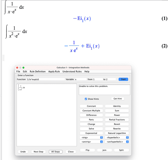

How do we solve these integrals?
Math software doesn't get me very far:
The window on the bottom is a sort of "math tutor" in Maple that shows all the steps in the calculation of the integral. However, for some integrals this step-by-step isn't available.
Now ##i_1(x)## is probably some variable defined within the depths of the dungeons of Maple documentation.
Still, what technique for solving integrals works for these integrals?
