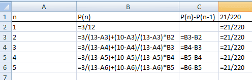

chwala said:
a more concrete approach

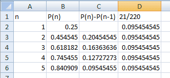

Excel:
The calculated value in C6 equals the target value in D6 when n=5.

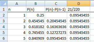

Hill said:
Excel:
ok @Hill, I can see that you're still using the same approach as I am, but you're doing it differently. For instance, following your method,
##P(2) = \dfrac{9}{12}×\dfrac{3}{11}=0.204525##
and so on.
Cheers man!

These formulas are behind my numbers:
I.e., ##P(n)=\frac {3}{13-n}+\frac{10-n}{13-n}*P(n-1)##
In my approach, ##P(2) = 0.454545##, but rather ##P(2)-P(1)=0.204545##.
## \begin{align}
P(n)&=\frac{9!}{(10-n)!}\cdot \frac{(12-n)!}{12!}\cdot3\nonumber\\
&=\frac{(12-n) \cdot (11-n)}{12\cdot 11\cdot 10}\cdot 3\nonumber\\
&=\frac{n^2-23n+132}{440}\nonumber
\end{align} ##
where ## P(n) ## is the probability that Marie picks a green ball on pick ## n ##.
I forgot to say that in my posts 3 and 5, ##P(n)## is the probability of picking a green ball on picks ##1## - ##n##. Thus, ##P(n)-P(n-1)## is the probability of picking a green ball on pick ##n##.
