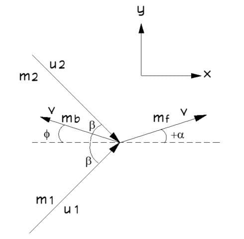

I'm trying to figure out what is the best way to solve the problem presented in the attached diagram which is a collision problem. The knowns are ##m_1, m_2, u_1, u_2,## and v (perhaps surprisingly). The half angle of the collision, ##\beta## is also known. The drawing shows what could potentially happen if the momentum of 1 exceeds that of 2, however, it could be the reverse or they could even be equal. I want to determine ##m_b,m_f, \alpha,\phi##. The oddity here is that the masses after the collision are not the same as before the collision, BUT, the sums are, so
$$m_1 +m_2 = m_f +m_b$$
I have tried several methods, but since I am new to them, I may very well have made errors that are keeping me from coming to a solution. In particular, when I start plugging numbers into a spreadsheet, some of the reasonable initial conditions result in ##m_b## being less than zero, which is not possible. I've looked at changing to the center of mass reference frame (which seemed somewhat promising, but I wasn't able to figure out how to get the angles) and the oblique collision method (had trouble getting the additional equation which supposedly comes from the coefficient of restitution). Those are the methods I have tried, but there may be others I should look at.
I'm looking for suggestions on what method to use to solve this problem. Thanks.

Let me write down the equations from what I've already done as per the link in reply #5. However, in that link I assumed that ##\phi = \pi+\alpha## and thus the outgoing streams were colinear. Let me remove that assumption. Let's look at the split of each body individually.
$$m_1u_1cos\beta = m_{f1}v_1cos\alpha - m_{b1}v_1cos\phi$$
where ##m_{f1}## and ##m_{b1}## are the splits in the forward and backward direction of the body #1 (actually a liquid stream but let's assume I can model it via particle collisions). I'm still assuming that the velocities of the forward and backward masses (##v_1## for #1) are the same. The mass conservation for #1 is,
$$m_1 = m_{f1} + m_{b1}$$
Similarly, for #2 the equations are,
$$m_2u_2cos\beta = m_{f2}v_2cos\alpha - m_{b2}v_2cos\phi$$
$$m_2 = m_{f2} + m_{b2}$$
For now, let's keep it simple and set e = 1. When e = 1, the splits from each individual stream, hypothetically, maintain their velocity as given by that stream before the collision (i.e ##v_1 = u_1## and ##v_2 = u_2##) . QUESTION: Should these equalities instead be the x-components of the velocities, for example, ##v_{1x} = u_{1x}##? EDIT: But if that is the case then doesn't that mean that ##\phi = \alpha## (I've already included the negative sign in the x momentum equations for each stream above)
There's also an equation for the conservation of momentum in the y-direction or line of impact direction,
$$m_1u_1sin\beta-m_2u_2sin\beta = m_fvsin\alpha + m_bvsin\phi$$
QUESTION: I don't think I can write individual stream or particle equations for the y-direction (line of impact) like I did for the x direction. But I'm not sure I understand why I can't.
Ultimately, the amount of mass in the forward stream is,
$$m_f = m_{f1} + m_{f2}$$
and for the backward stream,
$$m_b= m_{b1} + m_{b2}$$
with the idea being that the splits are theoretically combined without any loss of energy (since I've assumed e = 1). With loss of energy, I suppose I would have to assume that this combining was included in the coefficient of restitution.
So the y momentum equation can be rewritten as,
$$m_1u_1sin\beta-m_2u_2sin\beta = (m_{f1} +m_{f2}) vsin\alpha + (m_{b1}+m_{b2})vsin\phi$$
So, these are the unknowns: ##m_{f1},m_{b1},m_{f2},m_{b2}, \alpha, \phi##, which total six. I currently have five equations.
If I assume that ##\phi = \pi+\phi## so that the outgoing streams are colinear, I can already solve the system of equations.
So, I'm stuck here. Note, I am assuming that I know the value of ##v##, so if I do, I'm not sure that somehow incorporating kinetic energy equations will help.
EDIT: There is still an overall x momentum balance given by,
$$m_1u_1cos\beta+m_2u_2cos\beta = (m_{f1} +m_{f2}) vcos\alpha - (m_{b1}+m_{b2})vcos\phi$$
but I'm not sure I can use this since I already used x momentum equations for each body (stream) individually.
UPDATE: I've come up with equations for ##m_b,m_f## and plugged them into the overall y momentum balance. Now, I'm just picking some cases on what ##\alpha, \phi## might be just to check for consistency and if any negative values are generated (for example ##\phi = \pi - \alpha## or ##\phi = \pi +\alpha## or ##\phi = 0## or ##\alpha > \beta## and what if ##m_1u_1 = m_2u_2## in which case ##\alpha = \phi = 0##). So far, so good. The only time negative numbers are generated is for ##m_b## when ##\alpha > \beta,## but I already knew this from my previous work per the link posted in Reply #5. And ##\alpha > \beta## is not possible in a real world situation. As the momentum ratio increases ##\alpha## approaches ##\beta## but can never exceed it.
Just need that extra equation.

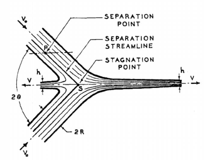

1) The drawing shown is actually pretty representative. Although I didn't realize it at the time I developed the equations in the link provided in reply #5 to this post, I think I am using the ideas developed for oblique collisions of particles (with regards to the tangential velocities). The link I posted in reply #5, shows a diagram of two equal liquid jets colliding in reply #18 of that post (the scattering angles are zero degrees in the forward direction and 180 degrees in the backward direction) and actual photographs of a liquid sheet formed from the collision in reply #12. The collision results in a stagnation point in the impingement zone around which liquid is deflected. However, the impingement zone is typically mildly turbulent, which is one of the reasons I believe that the velocity, ##v##, of each outgoing stream (f and b) will be equal. Early work on this phenomenon of equal impinging jets assumed that the velocities of the outgoing streams were equal but also assumed a perfectly elastic collision (so no turbulence; streamline flow only). I am not actually looking at impinging jets, but instead something that can be modeled in two dimensions only (x and y as I've been showing on the diagrams).
2) With liquid streams you can't assume that all of the mass transfer to the larger outgoing stream (assuming ##\beta## < 90 degrees) comes from one of the streams. Even if this problem was for particles, I don't know why you would assume that the mass transfer comes from only one of the spheres.
3) When you say that coalescence always results in KE loss, it seems to me that the coefficient of restitution can handle that, can't it. A perfectly elastic collision is, of course, idealized, but, imo, the formulas shouldn't fail if I decide to set "e" to 1.
rdemyan said:
1) The drawing shown is actually pretty representative. Although I didn't realize it at the time I developed the equations in the link provided in reply #5 to this post, I think I am using the ideas developed for oblique collisions of particles (with regards to the tangential velocities). The link I posted in reply #5, shows a diagram of two equal liquid jets colliding in reply #18 of that post (the scattering angles are zero degrees in the forward direction and 180 degrees in the backward direction) and actual photographs of a liquid sheet formed from the collision in reply #12. The collision results in a stagnation point in the impingement zone around which liquid is deflected. However, the impingement zone is typically mildly turbulent, which is one of the reasons I believe that the velocity, ##v##, of each outgoing stream (f and b) will be equal. Also, the pioneers of studying this phenomenon of equal impinging jets assumed that the velocities were equal but also assumed a perfectly elastic collision (so no turbulence; streamline flow only). I am not actually looking at impinging jets, but instead something that can be modeled in two dimensions only (x and y as I've been showing on the diagrams).
ok, I had not followed that link. It explains a lot.
But it seems to me that the idea of simulating it with a collision of a single pair of particles, with two-way mass transfer, is fatally flawed. Liquid streams have cohesion, which is why the diagram in post #19 there can show just two emergent streams. It would look very different with two streams of solid particles.
You say there:
"most researchers assume that the velocity of the liquid sheet, which forms from the stagnation point in the impingement zone, is equal to the jet velocity, "
but that would violate momentum conservation, and the paper you quote does not do that.

In the fluid flow diagrammed at post #19 of the linked thread, we could model it as two smoothly flowing streams, as though following a system of pipes. Each incoming stream, independently of the other, splits into two streams in opposite directions. With a suitable balance of flows, we can satisfy momentum conservation without requiring any net force from the imagined pipes. Bernoulli would apply, and KE conserved.
However, this does not really match two jets squirted together.
EDIT: The analysis presented here doesn't quite apply to impinging jets because they require a 3 dimensional analysis. What I've done here is to reduce the problem to two dimensions and the analysis does apply. So instead of two imping jets think of two impinging 2D streams only.
I've attached the diagram from reply #19 of the linked post to this reply. It is meant to be a diagram of two free liquid streams impinging upon one another. To keep it simple, assume that the streams are equal. I'm going to use the parameter terminology in the diagram attached as part of this reply and not the terminology I've been using in this thread for the diagram attached to the original post. So ##m_1 = m_2 = m## and ##v_{o1} = v_{o2}= v_o##. The half impingement or collision angle is equal to ##\theta##. The diagram assumes that the forward and backward streams that are formed have a velocity equal to ##v##. The key to understanding the nature of the collision (100% elastic, partially elastic, or inelastic) is the amount of backflow. Let's look at the x momentum balance:
$$mv_ocos\theta +mv_ocos\theta = m_fv - m_bv$$
where ##m_f## is the mass flowrate in the forward direction of the outgoing stream (to the right) and ##m_b## is the mass flowrate in the backward direction of the outgoing stream (to the left). An inelastic collision occurs if ##m_b## is equal to zero, i.e. no liquid is ejected out the back end. All of both liquids merge much like two spheres that stick together. The equation becomes,
$$2mv_ocos\theta = m_fv$$
but mass conservation always applies so
$$m_1 + m_2 = m_f + m_b = 2m$$
Now for the inelastic case, ##m_b = 0## and ##m_f = m_1 + m_2 = 2m##, so
$$v = \frac{2mv_ocos\theta}{2m} = v_ocos\theta$$
Kinetic energy is absolutely not conserved in this case and is lost as part of the collision. The coefficient of restitution for this inelastic collision is,
$$COR = \frac{v}{v_o} = \frac{v_ocos\theta}{v_o} = cos\theta$$
Now, for the case where ##m_b > 0##, the first equation becomes,
$$2mv_ocos\theta = v(m_f - m_b)$$
and
$$v = \frac{2mv_ocos\theta}{(m_f - m_b)}$$
Whether the collision is inelastic, partially elastic or 100% elastic sets the difference between the outgoing mass flowrates, ##m_f-m_b##. The maximum value for this difference is for an inelastic collision (because ##m_b = 0##). When ##m_b > 0##, the collision now is partially elastic to 100% elastic. The lowest difference in these mass flowrates (and hence the greatest outgoing stream velocity) is for the case where the collision is 100% elastic and ##m_b## achieves its greatest value. If we assume that the collision is 100% elastic, then by my definition of the COR above, ##COR = 1##. This means that ##v = v_o##, so,
$$v_o = \frac{2mv_ocos\theta}{(m_f - m_b)}$$
and
$$m_f - m_b = 2mcos\theta$$
as opposed to ##m_f-m_b = 2m## for the inelastic case. I want to look at the case where the incoming streams are not equal and hence have different momentums. I think you can see why I am focused on the mass flowrates of the outgoing streams. The inelastic collision case for the unequal colliding streams is simple to calculate since ##m_b## is equal to zero. But it's the elastic collision case which is challenging. At the same time I'm expecting any final solution to reduce to the equal colliding streams case discussed in this reply and also be able to handle the inelastic collision case of unequal streams.
That's not what coefficient of restitution means. The COR is a property of the two bodies involved and tells you what the result would be for a head-on collision. Oblique collisions need to be handled as I indicated, separating the motions normal to and parallel to the plane of contact.
You are assuming the forward and backward jets are at the same speed. Seems unlikely, but let’s see where it leads for the unequal streams.
In the frame of reference of the COM, you have two unequal masses colliding head-on at a speed ratio fixed by the mass ratio. This turns into two other masses ejected at right angles to the original velocities, different mass ratio but with the same relationship to the new speeds.
Once you choose the new mass ratio and fraction of KE retained, the new speeds can be calculated.
If you were hoping that both the new masses and speeds could all be deduced you are out of luck. To do that you will need a more detailed model of the process.
Applying a COM frame to two streams is tricky. COM of what, exactly? Could think of it as two streams directed head-on but with their sources moving at right angles to the streams. For simplicity, we can ignore the movement of the sources and add that back later.
The fully inelastic case now leads to a static pool of water. Experience says there will be some sideways splatter. This could be modelled as a pressure build up at the stagnation point pushing out in all directions, but that will not lead to an actual "backward" jet. It takes some cohesive force to pull it back into that form, and that will mean energy loss.
So here’s a possibility: consider the initial result of the collision as being water spurting equally in all directions (if the incoming streams are flat sheets, that's all directions normal to the line of intersection of the sheets). Assume no KE loss so far. Now add in the effect of the moving sources (i.e. an equal and opposite velocity to those). Next, separate the outflows into the bundle going out the side where the sources are headed (these are the backward flows) and the bundle going out the other side. Finally, on each side, collapse the bundle into a single stream by throwing away the lateral velocities (y components) and coalescing the x components.
Note that the backward stream may turn out to have a lower speed than the moving sources. This means no backward jet would appear.
Hope that makes sense. Hard to describe without a whiteboard.

It occurs to me that knowing the maximum velocity possible from the collision of these two unequal streams might be useful. How would I mathematically determine the theoretical maximum velocity of the two streams after impingement. I'm not sure if this means that absolutely no energy would be lost, but if I could come up with a way to determine the theoretical maximum that might be helpful.
Right now I am postulating that the theoretical maximum is,
$$u_{max} = \frac{m_1u_1+m_2u_2}{m_1+m_2}$$
If I instead use the kinetic energy equation (no energy loss) as a way to calculate this velocity,
$$u_{max} = \sqrt{\frac{m_1u_1^2 + m_2u_2^2}{m_1+m_2}}$$
However, comments by A.T. in reply#15 suggest that no kinetic energy loss can't happen, although it seemed like A.T. was talking more about an inelastic collision.
If I compare calculations of ##u_{max}## from the two equations, the value from the K.E. equation is higher than that calculated using the first equation. However, for a collision of equal incoming streams (equal meaning the same mass and velocity), both equations calculate the same result.
I'm looking for a way to derive what the maximum velocity could be of the two streams after the collision.

Let's start with a very simple case: two equal 2D blobs (so, discs) collide head on along the y axis.
The sideways splatter is symmetric about the y axis, but the distributions of quantity of flow and speed may be functions of the angle, alpha, to the x axis.
Intuitively, I suggest that relatively little emerges near the y axis, so cohesion leads to the splatter forming two flows along the x axis. Other than that consequence, for simplicity, suppose that the volume and speed, v, are the same in all directions.
Since the speed in the x direction of a given part is ##v\cos(\alpha)##, each of those flows consists of a core at speed v and successively slower outer layers.
We can transform this simple case into blobs converging from the left at angles ##\pm\theta## to the x axis by viewing them in a frame moving negatively along the x axis at speed ##v\cot(\theta)##. A flow layer with x velocity ##-v\cos(\alpha)## in the original frame now has velocity ##v\cot(\theta)-v\cos(\alpha)##. So a slower portion of the left moving flow is now seen as moving right, while the fastest may still be seen as moving left.
The next step is to allow each of the flows to settle down to a uniform speed by averaging over the fluid moving in that direction. It is feasible that these averages will be similar.

For equal impinging streams where ##m_1 = m_2 = m;u_1=u_2=u## the kinetic energy equation is
$$EL = \frac{2mu^2}{2} - \frac{2mv^2}{2} = mu^2 - mv^2$$
where EL means kinetic energy lost. Now when no energy is lost, ##v = u##.
However, as I mentioned previously I have been stating that the following works in a similar manner to the classical physics definition of the coefficient of restitution for the case of equal impinging streams,
$$COR = \frac{v}{u}$$
For an inelastic collision of the equal streams, the velocity of the stream after the collision is just equal to the x component of the velocity of the streams before the collision (which are equal). Note for an inelastic collision there is only one stream after the collision. Therefore,
$$COR = \frac{ucos\beta}{u} = cos\beta$$
Plug this into the energy lost equation
$$EL =mu^2 - mu^2cos^2\beta = mu^2(1-cos^2\beta)$$
but for this inelastic collision, ##COR = cos\beta##, so
$$EL = mu^2(1-COR^2)$$
So, the fraction of energy lost, F, is
$$F = \frac{mu^2(1-COR^2)}{mu^2} = 1-COR^2$$
Isn't this exactly the result using the Physics definition of the coefficient of restitution, e, namely that the fraction of kinetic energy lost is ##1-e^2## or if you prefer, ##1-COR^2##.
Now since the COR is equal to ##\cos\beta## for an inelastic collision of equal streams, the fraction of energy lost is proportional to,
$$1-COR^2 = 1-cos^2\beta = sin^2\beta$$
Thus, the energy lost comes from the kinetic energy associated with the y component of the velocity at impact, which is the velocity component along the line of impact. The velocity component along the tangent line, ##v_x## remains unaffected.
I should mention the definitions of elastic and inelastic that I use. A 100% perfectly elastic collision is where COR = 1 and from the above discussion, ##v=u##. An inelastic collision is the theoretical loss of energy assuming that all of the energy associated with the y component velocity is lost and the kinetic energy associated with the velocity along the tangential line (##v_x = ucos\beta##) is not lost. An elastic collision is where only a portion of the kinetic energy associated with the y component velocity is lost and again, none of the kinetic energy associated with the tangential velocity component is lost. For an elastic collision,
$$ucos\beta < v < u$$
