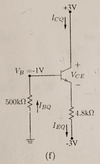

Determine IEQ ICQ IBQ
My problem is that this circuit is overdetermined and cannot be solved. (See below)
##\beta = 75##
##I_E=76 I_B ##
The current IB is calculated as ##I=\frac{1}{500}=.002mA##
The current ##I_E## is ##I_E = 76*.002 = .152 mA##
Similarly ##I_C= 75 * .002 = 0.15 mA##
The voltage ##V_{CE}## is calculated by knowing the current in the emitter and starting upwards from the -3V node, in other words
##V_{CE}=3-(-3+4.8*.152)=5.27V##Knowing this we see that there is a contradiction. The voltage drop across the BE is not .7 .
Is this a sound way of proving that the BE voltage doesn't HAVE to be 0.7?
Typically you don't know the beta of the transistor very accurately. A better assumption is probably that Vbe = 0.7 V, then calculate what the voltage is across the 4.8 kOhm resistor, then calculate IEQ, then beta. Beta appears to be significantly higher than 75.

Oh okay. Its just I was given the value of beta.

A base-emitter voltage of 0.7 V is a handy approximation suitable for typical design and analysis work. But it is just a "rule of thumb" sort of approximation, pretty good for silicon transistors under typical operating conditions. Not so good at all for germanium or other types of transistors.
The base-emitter junction is essentially a diode, and as such its forward voltage will vary like a diode; the IV curve is not a perfect vertical line at 0.7V. You may see forward voltages between 0.6 and perhaps 1.3 or so volts under different circumstances. Look up the "diode equation" .
