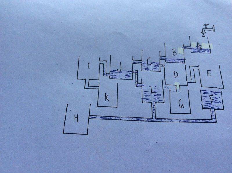

The picture.
Likes FactChecker and jerromyjon
  • #112
FactChecker said:
Flow rate should not be a factor. Obviously if you dump water in, A will fill up immediately. But the picture shows a slow drip into A and the instructions say to pay attention to the details of the drawing. The slow drip and the closed paths need to be accounted for in the answer.
I know the video is not a particularly good representation of the situation shown by the original question but it's the best I can find. I posted it here because it shows that the answer depends on the difference between the flow rate into the tank and the flow rate out of the tank.
The video shows that the tank fills up first when the water flows in quicker than it leaves The same applies no matter how quickly the water flows in because it's the difference in flow rates that matters. When the water level in the tank rises the rate at which water leaves increases. Equilibrium is reached if the level reaches a value such that water leaves as quickly as it enters. If that level is not reached, for example if the tank is not tall enough, the tank will fill up and then overflow.

See @Jacqueline 's attachment in post #111 and notice how high the exit of the line from J to I is.

F is the only one which will fill up. So F will not only fill up first, but be the only one.
All other remains empty or partially filled.
ABCJLF is the path.

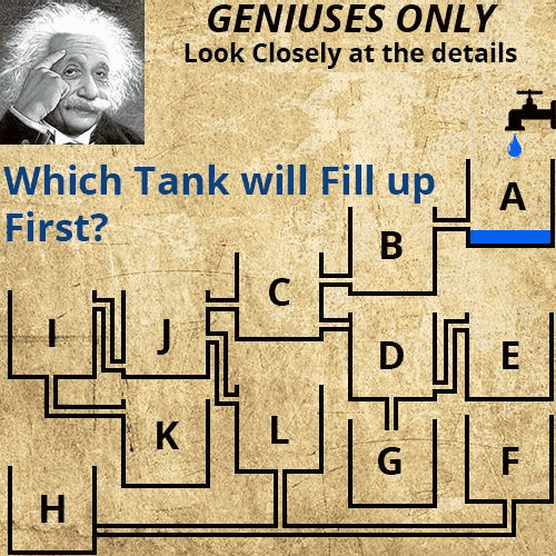

fahraynk said:
I originally thought tank K because the area in tank J is much larger than the area in the pipe connecting J to I
But then I realize Bernoulli's equation does not include volume but only includes height.
H_1, H_2 = height of water tank J, height of water in pipe between tanks J and I
P, p, V = pressure, density, velocity
$$P_1+pgH_1+\frac{1}{2}pV_1^2=P_2+pgH_2+\frac{1}{2}pV_2^2$$
Pressure terms are the same, so is density. Velocity = 0, gravity cancels out ##H_1=H_2##
So even in the small pipe connecting J to I, the water level is going to be the same as the height of water in the tank J.
Is this correct?
Also note the pipe from C to D is blocked off.
Also I assume A would be trivial solution so water must exit pipe faster than the tap fills tank A

My thought because of levels in and out: A to B to C to J to L to F. Funny how the mind can miss the blocks to D and H. I certainly missed the block at D :)
Is this correct?
Yes.
