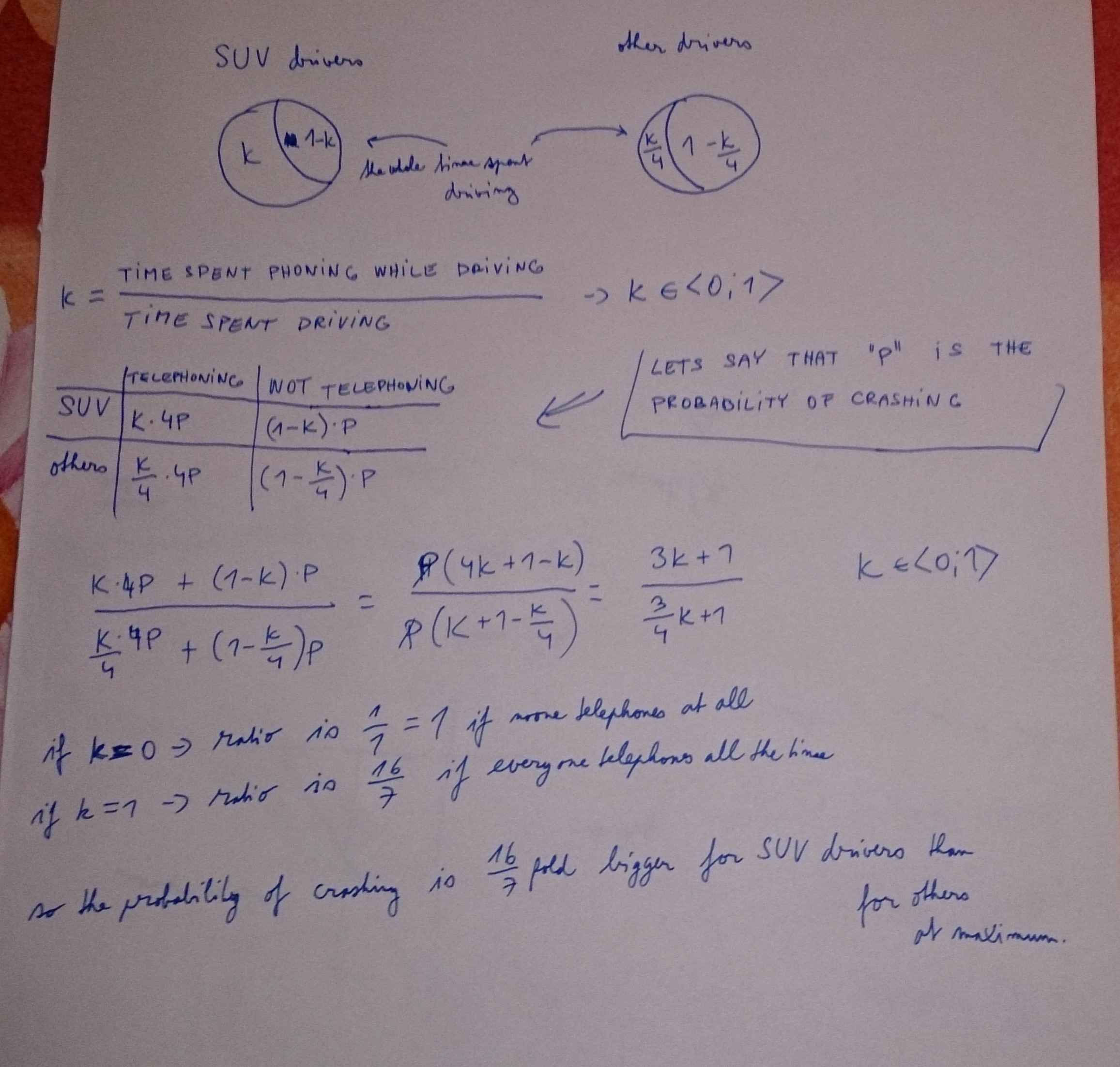

I am trying to solve this task: The SUV drivers use their telephone four times as often as the drivers of other vehicles. At the same time, using your telephone while driving increases risk of an accident fourfold. Does that mean that the SUV drivers are 16 times more likely to have an accident than other drivers? I would say yes, because 4x4 = 16, but I am still hesitating. Thanks for help.

What it actually means is that SUV drivers in general are 16 times as likely to have an accident as drivers who do not use a cell phone at all while driving. If we simply compare SUV drivers to other drivers, with SUV drivers using cellphones 4 times as frequently as other drivers, then we would only conclude that SUV drivers are 4 times as likely as other drivers to have an accident.

I am sorry to reopen this thread again... But I found another solution, which tells me that the result is 16/7... I took a picture of the solution, sorry for bad English, just please if you could check it, thank youView attachment 4992
