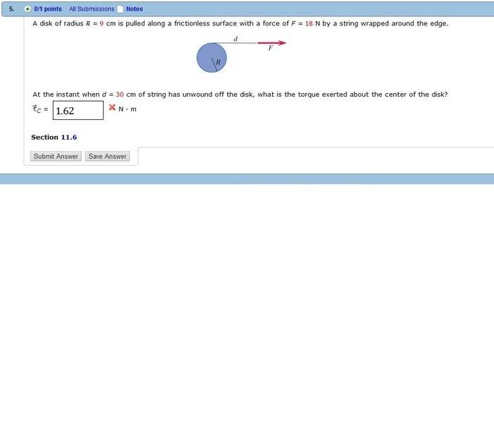

A disk of radius R = 9 cm is pulled along a frictionless surface with a force of F = 18 N by a string wrapped around the edge.
At the instant when d = 30 cm of string has unwound off the disk, what is the torque exerted about the center of the disk?
i tried \tau = R*F but it did not work can someone help me?
Seems right to me. Show exactly what you did.
i did .09m*18N and got 1.62 N*m but its wrong
Is the string tangent to the disk or at an angle?
tangent
ohheytai said:
tangent
Then I'd say that you answer is correct.
Post the entire problem including any diagrams.
okay here it is
I'd say your answer is correct. The distance is irrelevant.
Is this a stand alone problem or just one part of a longer problem?
stand alone.

the answer is <0,0,-1.62> N*m lol :)
