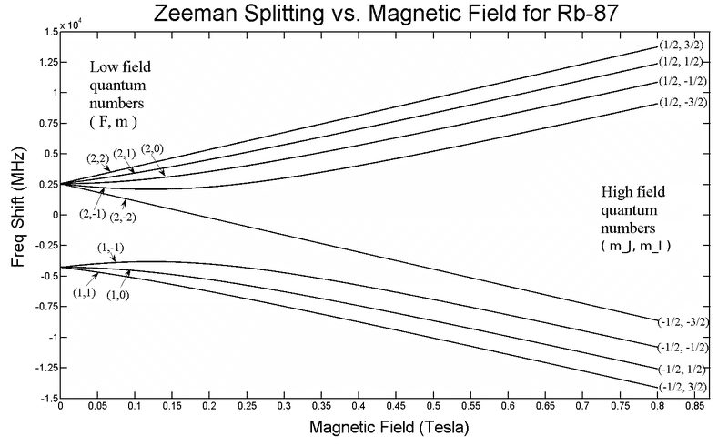

nmℓmsmjj
mℓ + ms
21.51.5+0.522
21.50.5+0.512
21.5−0.5+0.502
21.5-1.5+0.5-12
21.5-1.5−0.5−22
21.5-0.5−0.5-11
21.50.5−0.501
21.51.5−0.511

Where is that from?
sp3 hybrid orbitals are not eigenstates of the orbital angular momentum operator, so it makes no sense to talk about their ##l## value.
I am simply noting that the numbers match the image below it.
And I am no longer sure that it is an image of sp3 hybridization. It might be something else
