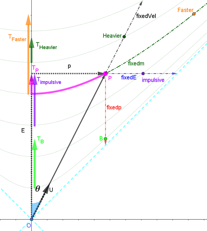

Just an fyi...
the OP asked this question earlier at
https://physics.stackexchange.com/q...acetime-interval-in-a-spacetime-diagram-relat
I contributed one of the answers with an energy-momentum diagram.
I think the question is asking
how,
while keeping mass fixed,
that increasing relativistic kinetic energy,
which increases the relativistic energy, the timelike-component of the 4-momentum,
also
increases the spacelike-component of the 4-momentum
and thus leads to a larger velocity (larger rapidity).
how,
also
Because you can't increase kinetic energy without also increasing momentum, surely?
Yes, when the mass is fixed, and likely other cases.
But, I suspect that these various concepts haven't been fully connected by the OP
...and others (from similar questions I've seen in the past, here and elsewhere)...
there are misconceptions...
...hence the energy-momentum diagram.
Note that if we allow the mass to change [decreasing mass],
increasing the kinetic energy (as example "B" above)
can be done
with constant relativistic momentum
and decreasing relativistic energy.
So, I think the diagram helps,
as well as the important idea that one has to be specific
about how one varies quantities (especially when taking limits... like how to get to the massless case).
