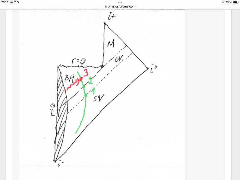

Your understanding is incorrect, at least as far as inferring that there is an issue with conservation of energy and momentum.
I don't have ready access to digital tools for drawing spacetime diagrams, so I drew one by hand and scanned it:
The shaded region on the left is the collapsing matter that forms the hole.
The "SV" region is the Schwarzschild vacuum region outside the collapsing matter, before the evaporation process starts. This is the region I referred to before as being to the past of the outgoing Vaidya region.
The "OV" region is the outgoing Vaidya region. Note that all null lines through this region have endpoints at the collapsing matter region.
The "BH" region is the black hole. The geometry in this region, outside the collapsing matter, is Schwarzschild vacuum interior to the event horizon. However, as noted below, the radiation from the hole's evaporation is not coming from this region! (If you think about it, you'll realize that it can't, because the radiation from the hole's evaporation goes out to future null infinity, and the black hole, by definition, is not in the causal past of future null infinity.)
The "M" region is the flat Minkowski region that is left once the hole has completely evaporated and the last bit of radiation has gone outward to infinity.
The boundary between "BH" and "OV" is the black hole event horizon. The boundary between "OV" and "M" is the last bit of radiation from the hole's final evaporation, going out to infinity.
Note that, while it's true that the "r" coordinate everywhere in the "OV" region is greater than the "r" coordinate everywhere in the "BH" region, it still doesn't really make sense to say that the "BH" region is "inside" the "OV" region. As noted above, the outgoing null dust in the "OV" region is coming from the collapsing matter region, not the "BH" region.
Thanks, yes, this does resolve my confusion. I had misunderstood the arrangement of the various regions.

This boundary does concern me. The OV metric has a white hole horizon. Is it even possible to find a consistent junction condition with a Schwarzschild BH event horizon?
Not the OV region in the model, no. There is no white hole horizon anywhere.
The maximal analytic extension of the OV metric has a white hole horizon, but that portion of the maximal extension is not used in this model.
In a Penrose diagram of the type shown, a white hole horizon would go up and to the left. It would be the boundary of a region that an observer starting from past timelike infinity ##i^-## or a null line starting from past null infinity could never get into. Or, to put it another way, it would be the boundary of a region that is not in the causal future of past null infinity (the time reverse of a black hole horizon, which is a region that is not in the causal past of future null infinity).

Maybe I am mising something important. Imagine green observer with its proper time. You say that mass of bh decreases to zero between points (and greens times) 1 and 2 ? Then, how he can see some photons at point 3 eventually emmited from collapsing surface ? Or he cant ?
In the model as I described it, he can't, because there is no radiation in the BH region. As I said in post #15, the geometry of that region outside the collapsing matter is the vacuum Schwarzschild geometry interior to the horizon. That means there can't be any radiation present.
One could construct a model in which the collapsing matter does emit radiation inside the BH horizon, and that radiation goes into the singularity and gets destroyed. The geometry in the BH region in such a model would be more complicated, and it wouldn't change what's visible from outside the horizon, so I didn't bother considering that complication.

Tomas Vencl said:
Would it be possible to draw diagrams of the more realistic models considered by both of you? Thank you.
I don’t know that it is more realistic by any means. But I can do a diagram later
