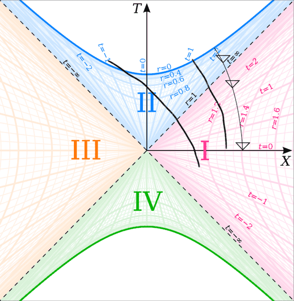

Wikipedia has a Kruskal diagram which shows a maximally extended Schwarzschild spacetime. The right hand region is the exterior and the upper region is the interior. The singularity is the hyperbola across the top, and the ##r## coordinate lines are marked. I've pasted it below (thanks to @DrGreg) sketched in a couple of worldlines of infalling observers in black (probably not completely correctly, but roughly ok). You can see the separation between them growing until they strike the singularity.

for the Kruskal diagram. Just from a beginners view: Do I see it correctly that depending on where you start falling into the black hole you end up at the singularity at a certain time and position (x?) so starting at r=1.4 following that line you end up at r=0 but x is still approx 1.25. so what is then the meaning of the x coordinate ending up for example at the point (t=2,r=0) of the right side line in the figure?
In Schwarzschild coordinates ##(t,r,\phi,\theta)##
  • outside the event horizon (region I)
    • ##r## represents a distorted distance
    • ##t## represents a distorted time
  • inside the event horizon (region II)
    • ##r## represents a distorted time
    • ##t## represents a distorted distance
In Kruskal coordinates ##(T,X,\phi,\theta)##, in all regions,
  • ##X## represents a distorted distance
  • ##T## represents a distorted time
(To be pedantic, when I say "represents a distorted distance" I really mean "is a spacelike coordinate", and when I say "represents a distorted time" I really mean "is a timelike coordinate".)

in #2 you say: 'the Schwarzschild singularity is a line - it is more like a moment in time than a place in space.'
but if I interpret the picture in #4 then I see the singularity as a line with r=0 and time having different values. so based on that I would conclude that the singulatity is a point with zero dimensions, but with all moments in time so not one moment in time.
so for me there are still some mysteries left:
1)
I understood that for points in region 1 time flows forwards (as this is our 'normal' world), but crossing the event horizon time goes to infinity, so that would be as seen from the opserver outside the black hole looking at the particle falling in I suppose. But the orginal question was about how the picture looks as seen from the observer free falling into the black hole towards the singularity including a mist of particlea around him in freefall with him. And that observer following particles that are for example 1cm in front of him (1 cm compared to his measuring device) in the path following together.
so then distances cannot be interpreted in the way as represented in the picture I suppose, so for me not sure how to interpret the distance between the 3 sketched lines in the picture. so How should I understand that for every particle 1 cm away, the particle is acellerating away from the observer and how that looks like just before hitting the singularity?
2)
does time stop at the singularity? so is it possible to followthe blue line going to the right? (time is plottet represented by straight lines with time related to the angle of the line, so I then would expect that that also holds for the singularity?)

HansH said:
r=0
It's important to realise that ##r## is the timelike coordinate inside the black hole. You can see that by considering the sign of the Schwarzschild coordinates ##dr^2## and ##dt^2## terms in the metric for ##r## greater than and less than the Schwarzschild radius. Thus the singularity has 1d spatial extent (the circumference of a circle in the ##\theta## and ##\phi## directions is zero at the singularity, so it's 1d) but no timelike extent. That's more like an instant in time than anything else.
The diagram is a very distorted representation of the spacetime and obeys some of the same rules as a Minkowski diagram. Specifically, light travels on 45° lines, which is why the event horizon is one such, and any definition of "time at one place" is a line above 45° (one of my worldlines probably dips below 45°, but that's bad drawing on my part).

Neither time nor space is defined at the singularity. If we were being rigorous, most claims about what happens "at" the singularity would be replaced by claims about limiting behaviour as one approaches the singularity.

I still don't see why spaghettification can't occur in a spatially radial direction when you fall along. The particle in front of you stretches away from you doesn't it? How fast does that happen?
  • #31
The Kruskal "time" coordinate has different values at different points on the singularity line, but so does the Kruskal "space" coordinate, so you can't conclude anything just from looking at the coordinates. You have to look at the metric and see what kind of line the singularity line is.
When you do that, you find that the singularity line at ##r = 0## is a spacelike line, and that is the case regardless of any choice of coordinates. That means different points on the singularity line correspond to different places, not different times, if we use "places" and "times" in the ordinary way those terms are used in everyday conversation.
