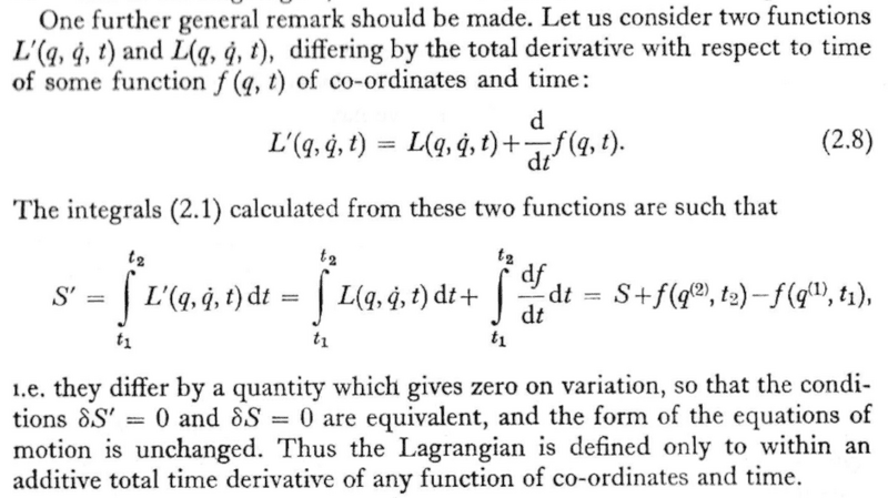

Are you sure? ##4x^{3}v_{x}=4x^{3}\dot{x}=d\left(x^{4}\right)/dt## is a total time derivative.
Ah, I see. In one dimension, yes, this is true--but then it's confusing why ##v_x## is written in the second term but ##v^2## in the first.

As far as I can tell, L&L do not discuss the fact that you can add a total time derivative to a Lagrangian without changing the equations of motion.
From Landau & Lifshitz, Mechanics (3rd ed.), pg. 4:
Likes PeterDonis and cianfa72

##4x^3v_x = 4x^3\dot x##. It is the ##\frac {d} {dt} \left (x^4(t) \right )## therefore it is the "standard" free particle Lagrangian written in an inertial frame + a total derivative term.

Ah, missed it. Thanks!
Their further discussion appears to assume that no total time derivative term is added and should be read with that qualifier in mind.
