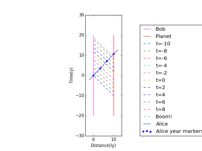

Imagine the distant planet sending out pulses, one per year. The "t=-10" pulse arrives at Earth just as Alice passes Bob. They will both receive the "t=-10" pulse at the same time, since they are at the same location. So all three clocks are synchronized at this space-time event. If Alice and Bob each had telescopes trained on the clock on the distant planet, they would each see that clock reading -10 years at the instant that Alice passes Bob. Since Bob knows the planet is 10 light years away, and they are not in relative motion, he knows that at the instant he receives the "t=-10" pulse, that a clock on the planet would read t=0. So Alice sets her clock to t=0 at the instant she passes Bob, and all three clocks are synchronized. As Alice moves toward the distant planet at a speed close to that of light, she is intercepting the pulses and so seeing the clock on the distant planet run faster than her own. All observers will agree that the instant the clock on the distant planet reads 9, the planet explodes.
Attached is a space-time diagram. Note that Alice receives more than three pulses during one of her years, so she sees the distant clock running more than six times faster than her own (I've only drawn the eevn numbered pulses). Notice, also that she sees the planet explode (at the same time that the planet's clock reads 9) before she arrives.
(Note that I made a few edits to make the text agree with the diagram.)

phyzguy said:
Imagine the distant planet sending out pulses, one per year. The "t=0" pulse arrives at Earth just as Alice passes Bob. They will both receive the "t=0" pulse at the same time, since they are at the same location. So all three clocks are synchronized at this space-time event. If Alice and Bob each had telescopes trained on the clock on the distant planet, they would each see that clock reading zero at the instant that Alice passes Bob. As Alice moves toward the distant planet at a speed close to that of light, she is intercepting the pulses and so seeing the clock on the distant planet run faster than her own. All observers will agree that the instant the clock on the distant planet reads 9, the planet explodes.
If you draw the spacetime diagram from the perspective of Alice, the result becomes more apparent. The frequency of photon release would be lower for her. She takes into account the distance the light had to travel to reach her in order to calculate when the photon was released. It is obvious if you think of the clock as being a light clock. It also become apparent by drawing lines of simultaneity on your diagram
